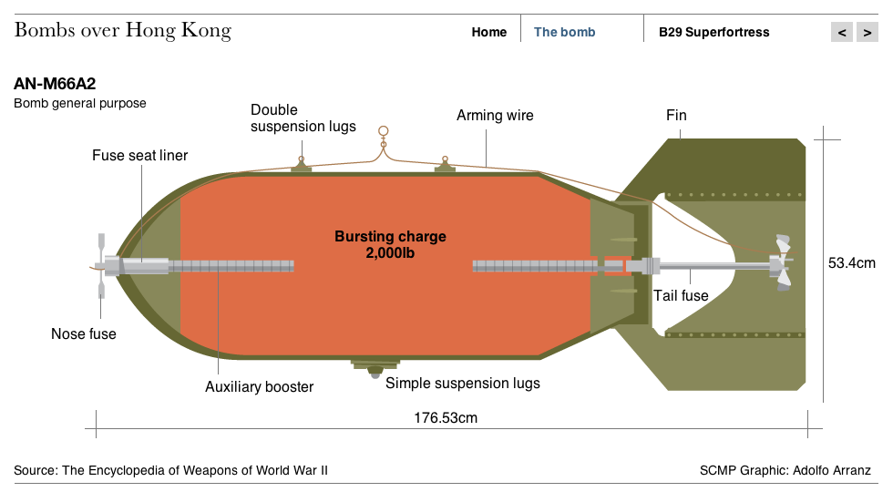

The two bombs under the center section look a lot bigger than a 1000lber too --
Quote from: joncarrfarrelly on November 22, 2019, 12:52:46 PM
Maybe a pair of 2,000 lb bombs?
That's what I was thinking Jon, now I've got another ordnance option, only using the Mk.84 ----  ;D
That top photo is fascinating mate and I wasn't aware of the 2,000 lb bomb so thanks Jon. :thumbsup:
