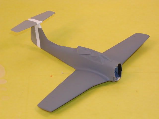

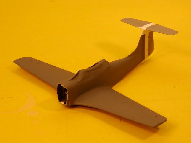

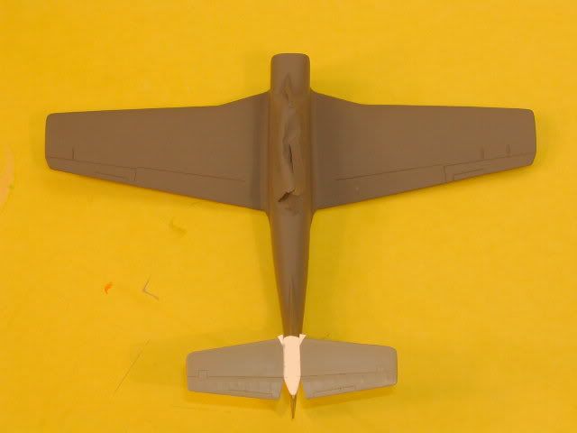

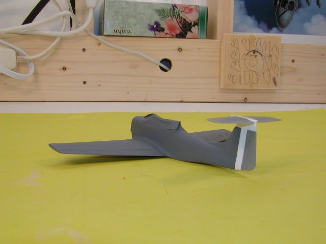

Ms. Hitler and The Spawn are at some girlie function, somewhere...so, I finally got some time on the workbench!

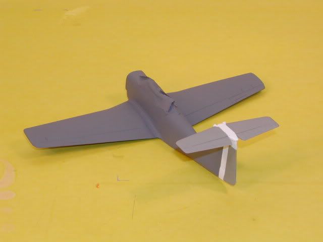

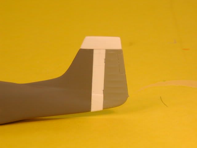

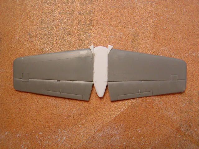

All 16 pieces for the T-Tail have been cut, shaped, and glued into place.
Still have some work to do on the little wedge-shaped filler bits I had to stick onto the join b/w tailplanes and middle/anchor section before I attach the final assembly to the modified tailfin.
The shots you see here are just test shots with the tailplane temporarily balanced on the tailfin.  The tailplane itself is still very rough at this point.

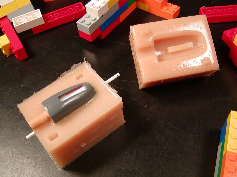

Later, I'm going to pour the second half of my mold for the modified (lengthened) nose cowl.  It will be my third attempt to get a worthwhile mold of the part, so wish me luck.

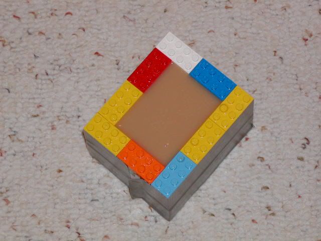

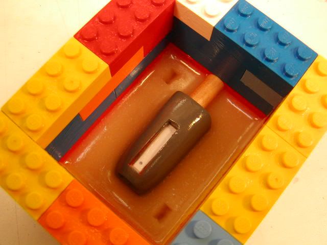

Not the most exciting pics, visually-speaking, but if this other freakin' half of the mold finally works this time, I will be able to cast my elongated nose cowl properly and that means the whole airframe will finally come together!
Mold half one complete with little cut-out register keys---yesterday:
And I finally managed to get the second half poured today (yes, I remembered both of the mold release agents this time!).  Mold half two---tonight:

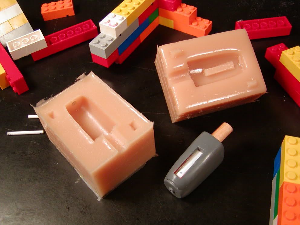

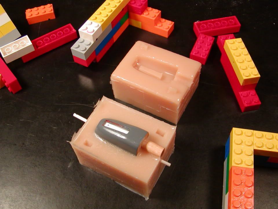

Well, I demolded the nose cowl tonight.  Everything looks pretty good so far.
Pic 1: Mold is removed from the Lego blocks.
Pic 2: Mold is shown in its two halves.

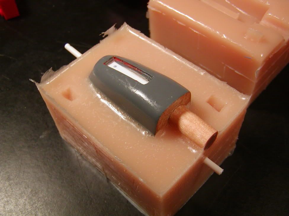

Pic 3: Close up of the mold's lower half with the subject nose cowl still in place.
The wood dowel will become the pour gate for the resin when casting (like the sprues on an injection-molded kit).  The thin white tube below the dowel will create a narrow tunnel in the mold when removed.  This tunnel will be a vent so that air has a place to escape when it is displaced by the resin entering the mold cavity during the casting pour.  The opposite thin white tube was simply another pin to help suspend the subject nose cowl in midair while the mold rubber lower half was poured.  The hollow tube its removal will create must be filled with modeling clay when it comes time to pour in the resin. Try lining up the drilling for all THESE dowel holes and such in mini LEGO molding walls!
Pic 4: The subject nose cowl has been removed from the mold and both mold halves look good!

Hopefully the Smooth-On resin will work out (and I get Friday off, too: yahooooooooOOO!!!)
