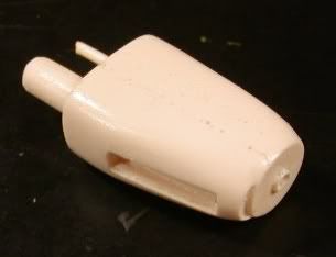

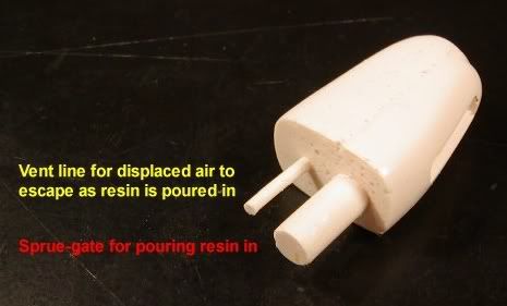

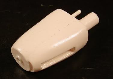

Well, cowl casting went pretty well.   This was the "last chance" mold that I knew I'd have to clean up any castings which resulted anyhow.
As usual, the Smooth-On ™ casting resin created a lot of surface air bubbles as I find it often does in two-part molds.
The resin is injected using a large capacity syringe (helps to have a wife who's a Veterinarian).
K5054NZ
Nice work! You should get into the accessories business  ;)
Ollie
There be air bubbles in yer cast nose matey!
:ar:
Yep, like I said, on try number 3 here, I slathered the master subject with Vaseline and did not care about the surface condition, just the shape.
I was going to fill in all the surface pinholes but many of them are in a nice straight line with the mold separation line and look just like rivets.
So, wth, I might just leave them be!

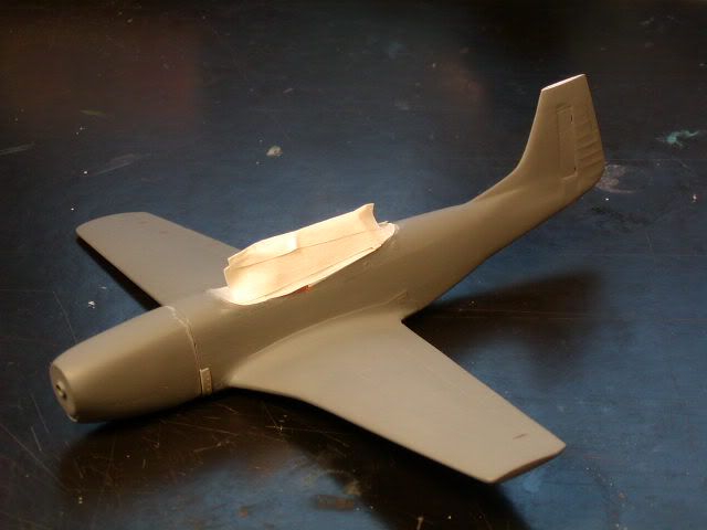

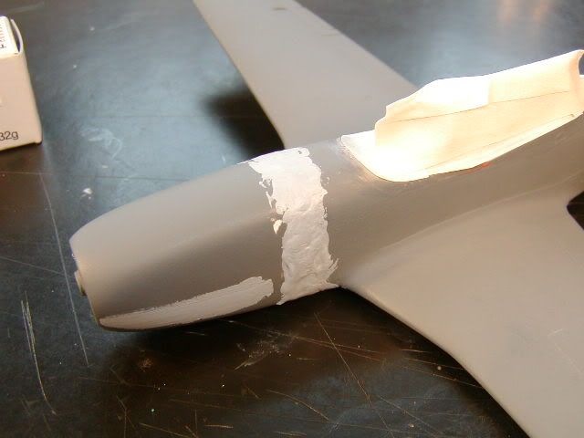

The NICE way to put this is to simply say:
"Looks like I have some putty work ahead of me."  --sigh--
:unsure:  :o  :wacko:  :zzz:
Can smell the putty fumes from here !  Once done, that is going to be awesome...that'll snarl the jmn's to no degree...

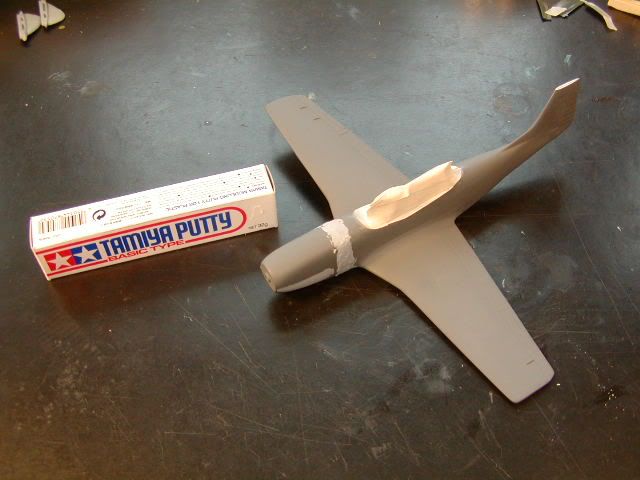

Yikes!  With the amount of Tamiya putty I use in a month, I figure I should be one of their spokesmen:
Close up of the carnage:

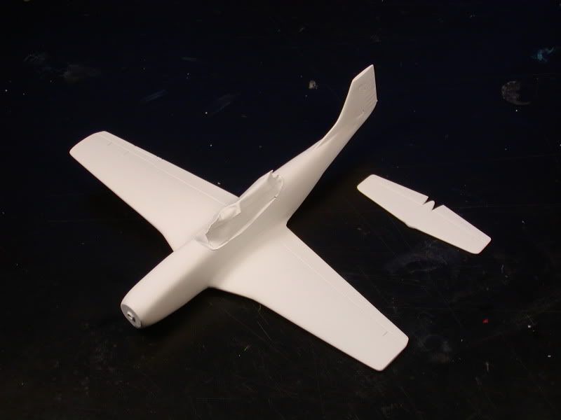

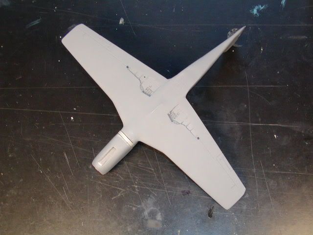

It's finally white!  Seven coats of primer white have eradicated any hint of Monogram's raised details.
I will put in some very subtle (I hope) traces of panel lines etc. with a 2H pencil later.
She'll have near black anti-glare panel and walkways as well as red wingtips and tailfin.
