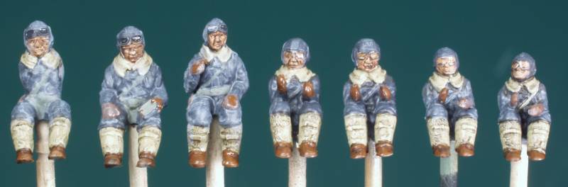

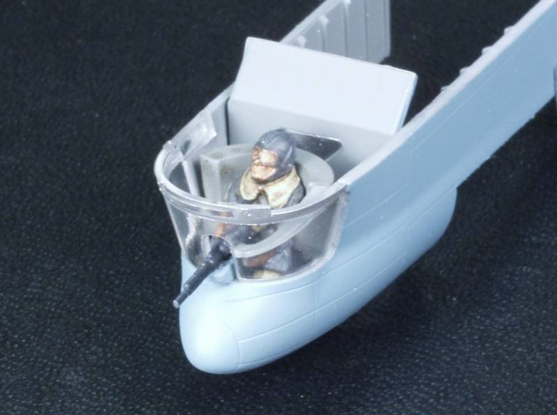

At least they would be warm.  I have a Zvezda 1'72 which has figures for all the crew including the engine gunners.
I've got that kit in the stash, but never noticed the gunners, but then I don't use crew figures. If I ever get around to the kit then I might make an exception in this case  :thumbsup:
Either Zvezda have used variable scale or the nacelle gunners (on the right) were recruited from Hobbitograd...
