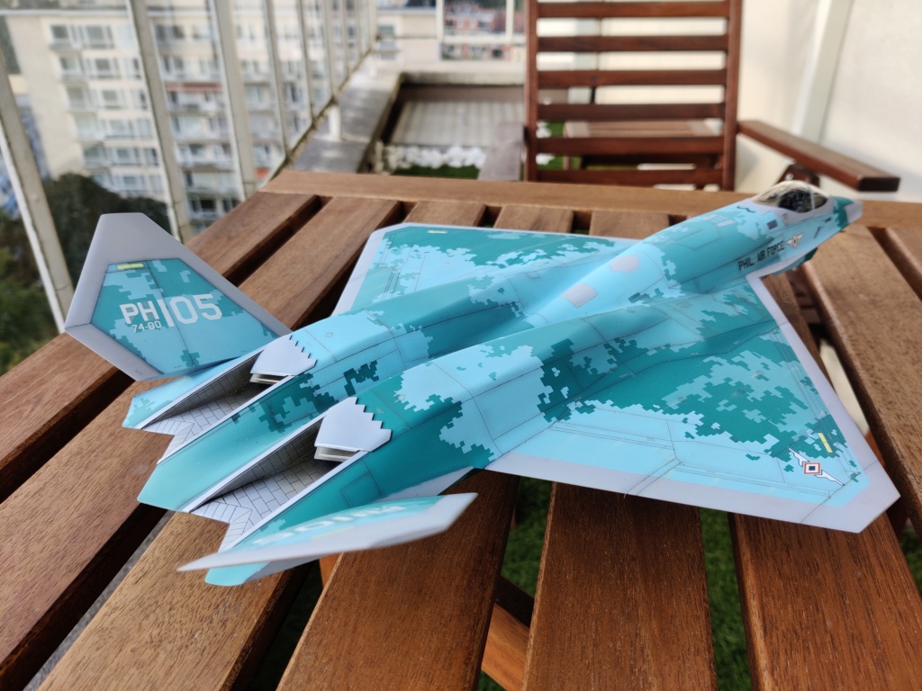

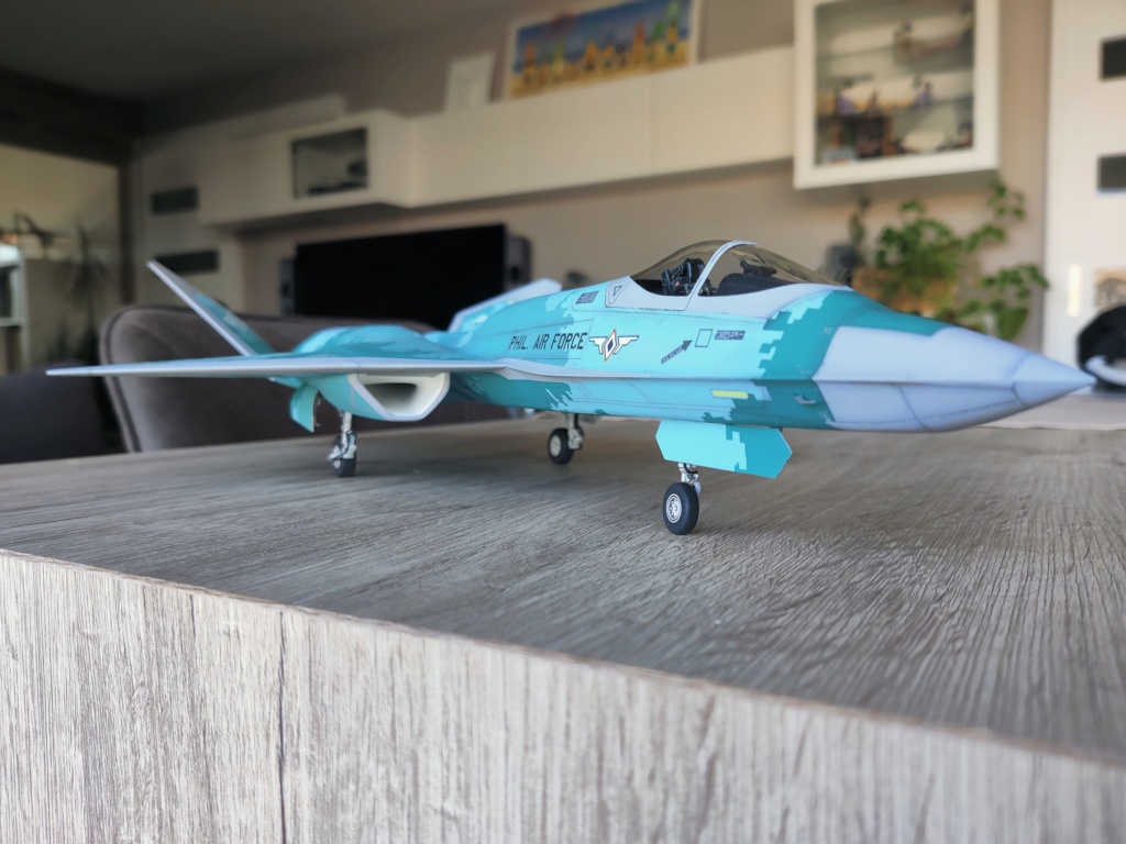

Hi there,

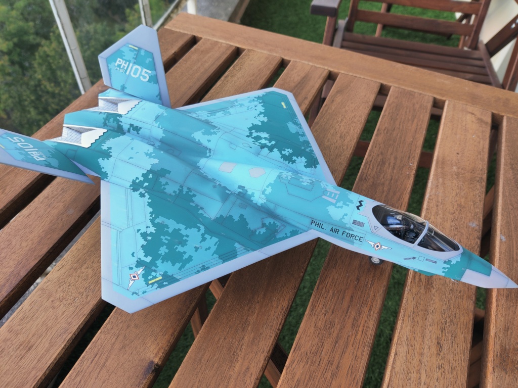

yes yes another plane is ready ...but don't get fooled, I have a lot of builds stuck in decal/weathering phase, so this fast pace is the result of years past ^^
Anyway, YF23 Philipines Air force
kit: Hobbyboss
décals: Aztec and Caracal
paints: MRP 203 204 202
masks: Foxbot for SU30
aftermarket: True details seat, Scale Aircraft Conversion undercariage

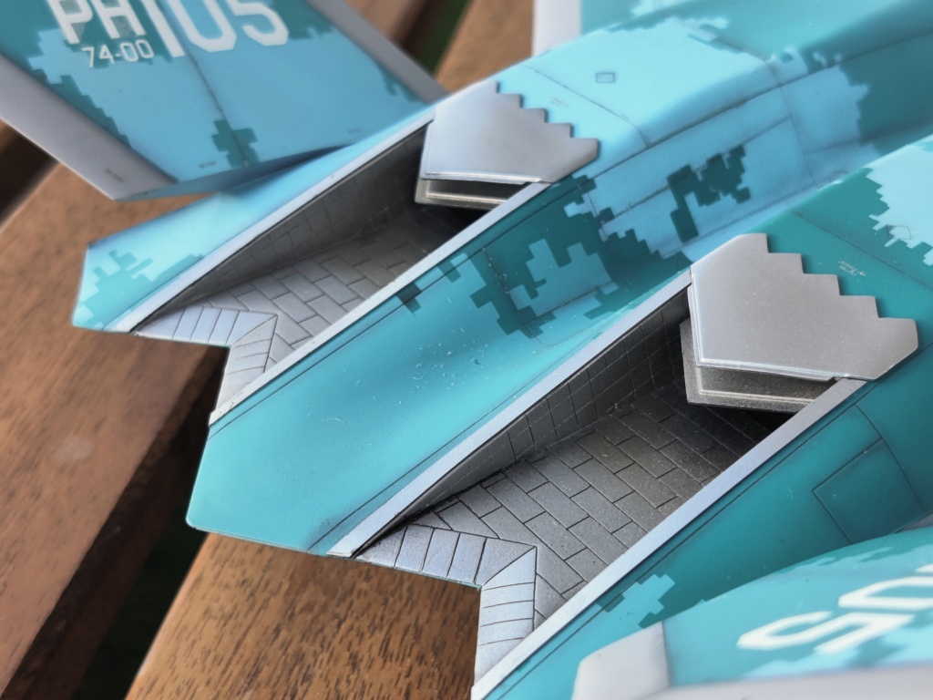

Overall a fun build (great details in the cockpit and wheelwells) but 2 major flaws. Exhausts have to be rescribed on the vertical surfaces and the wings are thinner than the fuselage. Had I known I would have glued the wings to the fuselage halves, but I didn't so a lot of putty was needed.

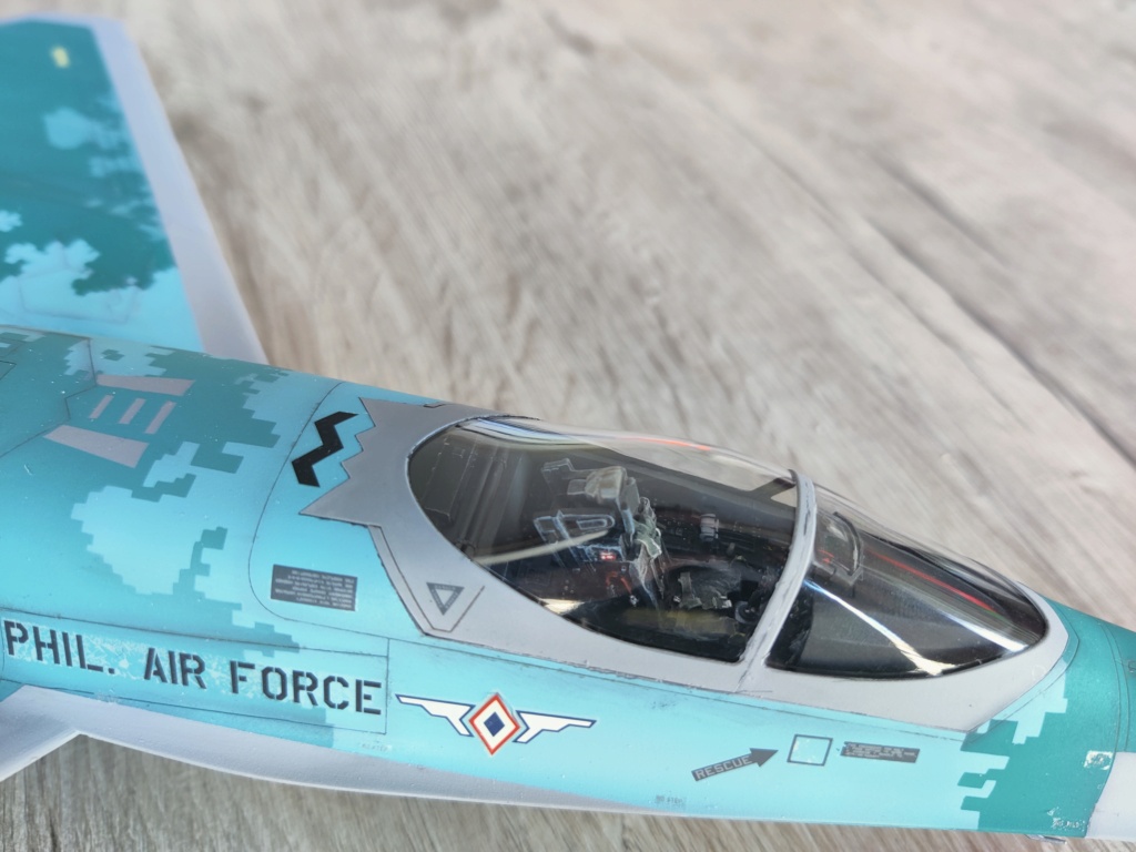

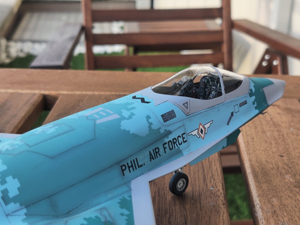

Some issues with the decals as well, the ones from Aztec show a lot of silvering on the text ones (Phil air force and big 6 on tail).
In the end, an impressive bird and a cool addition to my collection.
Comments and remarks more then welcome  :thumbsup:
Cockpit detail is great, only the seat needs te be changed.

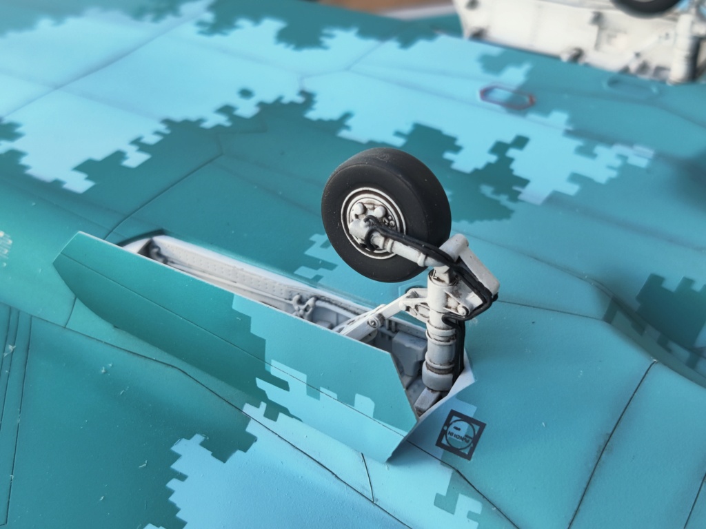

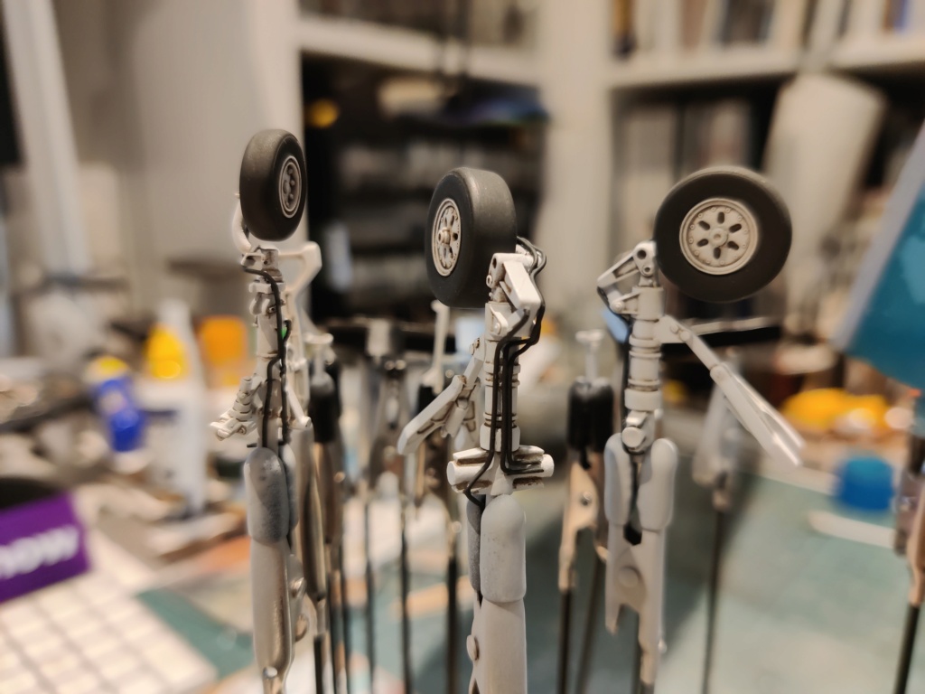

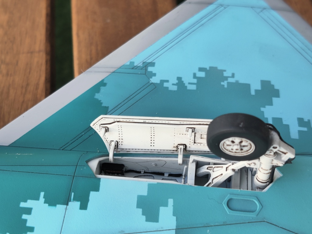

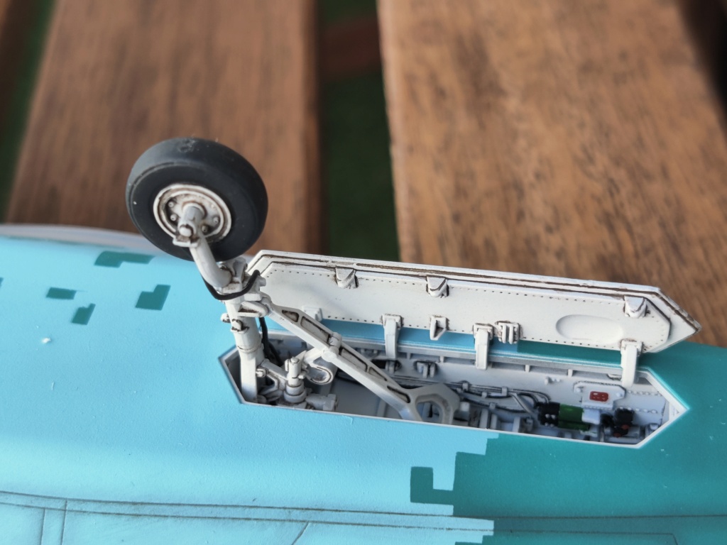

Details on the wheelwells are nice but the undercariage is lacking wires. Also they have to be replaced with metal ones. The plastic ones bend under the weight of the plane. Scale Aircraft Conversion pieces fit the kit like a glove as they are copies of the plastic parts.

That's an awesome scheme & build, flappydaffy! :bow: :bow:
Would you call that digital camouflage or is it more segregated edged ?
Whatever it's a fantastic build and great cockpit  :bow:
Glenn Gilbertson
Phenomenal work ! That thing is out ofthis world. Nice one !
Wow.  Great build.
The entire Philippine Airforce budget spent on one aircraft...
FAR148
Dude! That digital camo job is off the chain  :o :wub: :thumbsup:
Awesome, just Awesome!

I will go with Digital Camo :D Not my first, but first time I use pre-cut masks (somehow it makes the paintjob way  faster, go figure...)

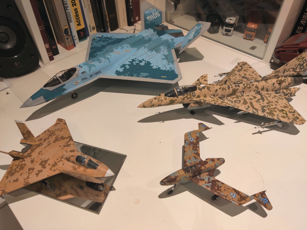

Just for the fun of it a group picture
