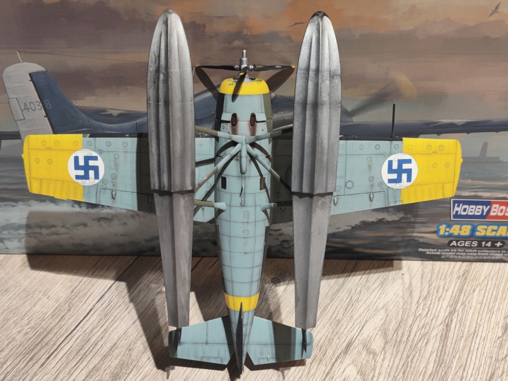

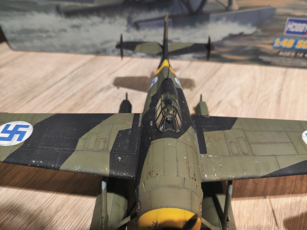

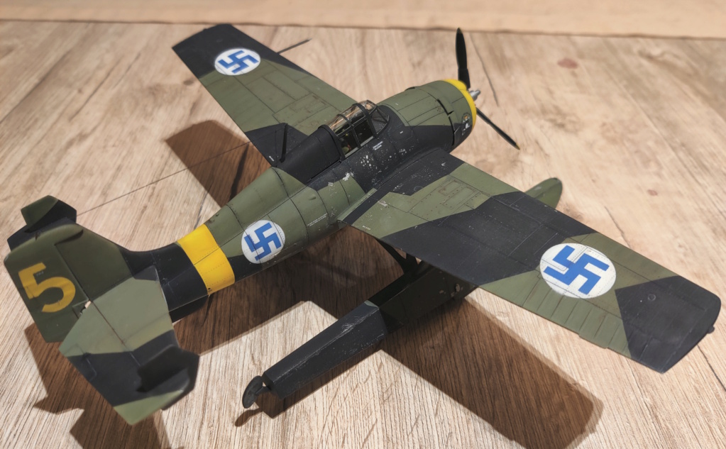

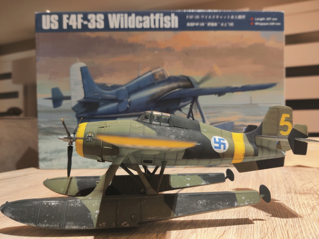

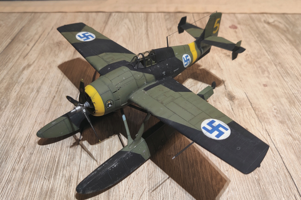

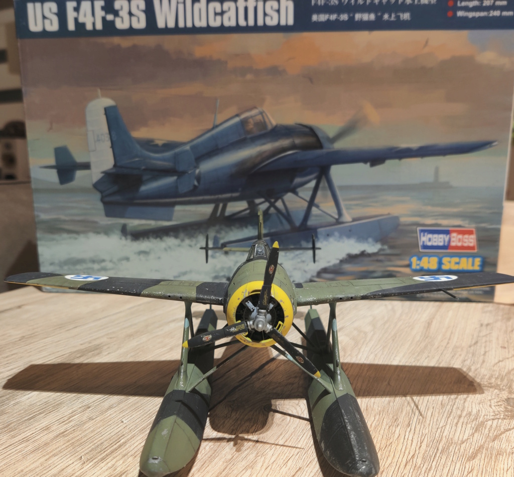

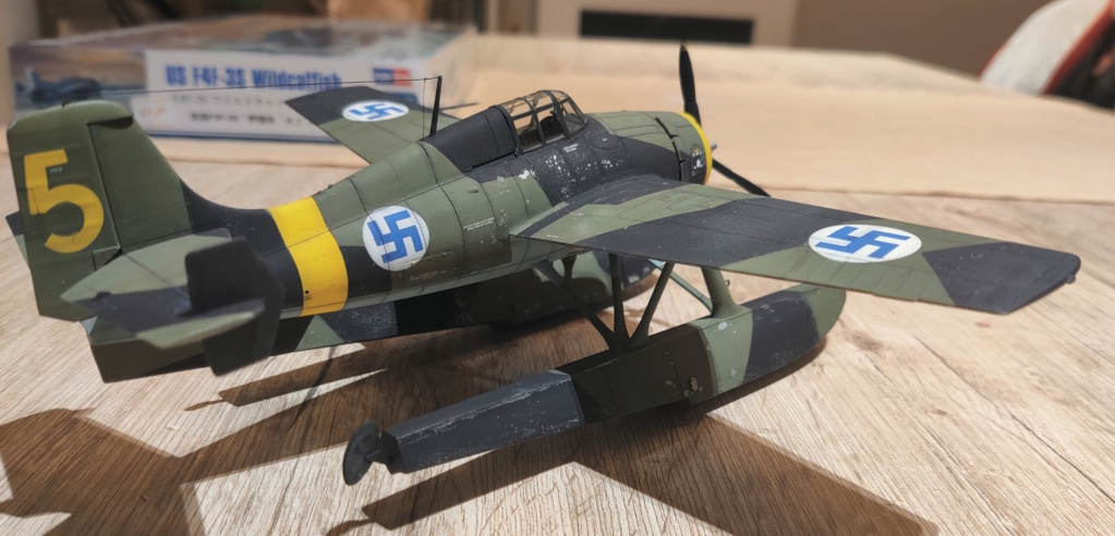

After testing by the navy, the conversion kit for the Wildcat caught the eye of the Finnish High Comand. Having ordered Wildcats to be able to operate them from short hidden airfields, the floatplane conversion was the next logical step. They would make it possible to them in the fjords (and the Fins had the impression they had a few of those). Short testing confirmed that water surface had good resistance to bomb impact, no mater how often the bomb struck it, it always returned to a flat surface in a few minutes... what else of an excuse did Finland need to order Wildcatfishs?
F-4F 3S Wildcatfish
kit: Hobbyboss
décals: TEchmod
paints: Tamiya and Gunze
masks: Montex (roundels)
aftermarket: Eduard photoetch (cockpit) Aires (Engine)

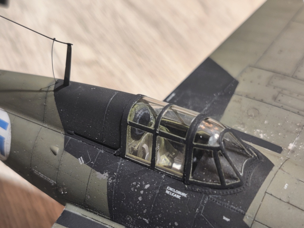

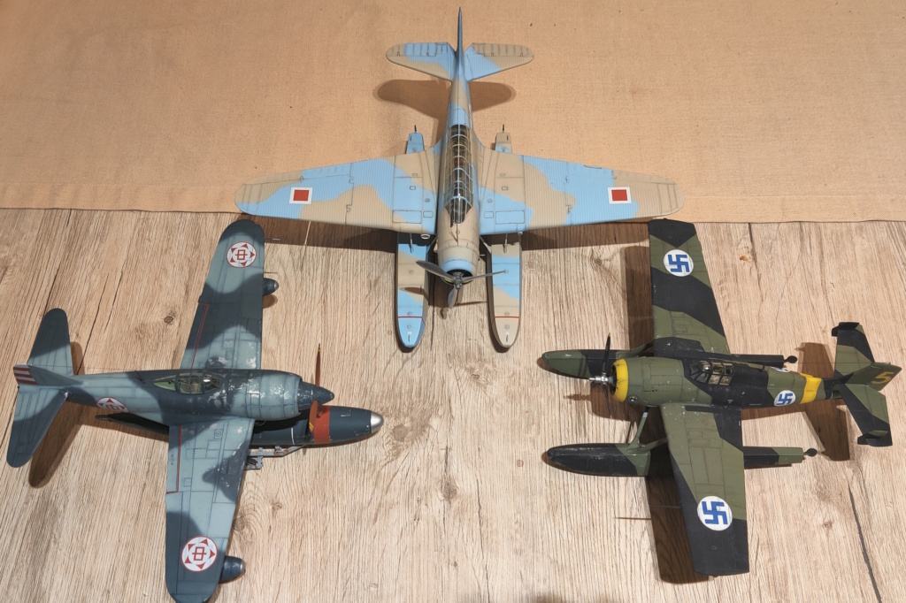

i couldn't find pictures of the build  :banghead: in order to make it sit on its floats, lots of weight was added to the tip of the floaters and just behind the engine. This resulted in a cracked canopy  :banghead: :banghead: :banghead: the excessive weight in the nose tipped the plane over when the float were not installed and it landed on the canopy  :banghead: I will try to find a replacement one, but this is no prio... in the meantime enjoy the pictures
Let's not forget the familly portrait #floatplanes for the win!!

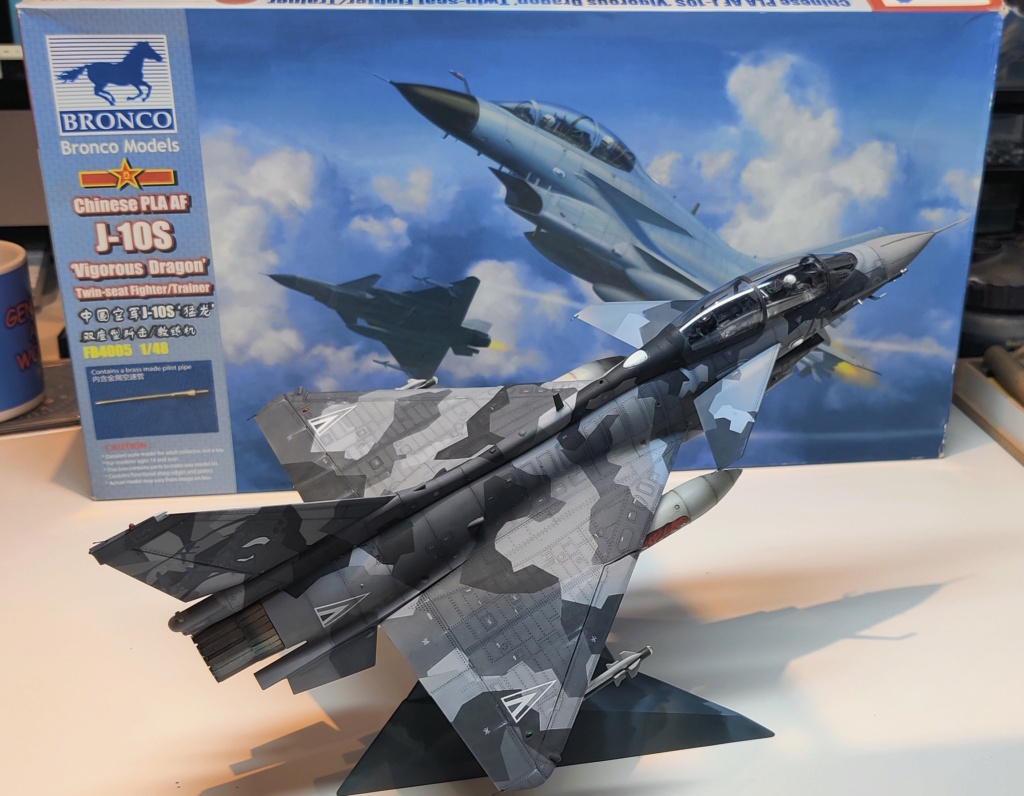

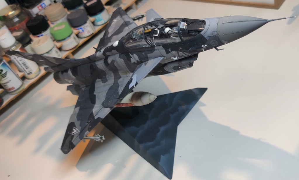

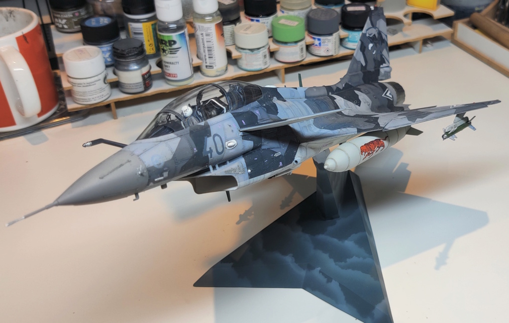

J-10S Vigorous Dragon
kit: Bronco
décals: HAD
masks: DN Models
aftermarket: PJ production (pilot) Aires (seats) Dreammodel (exhaust)

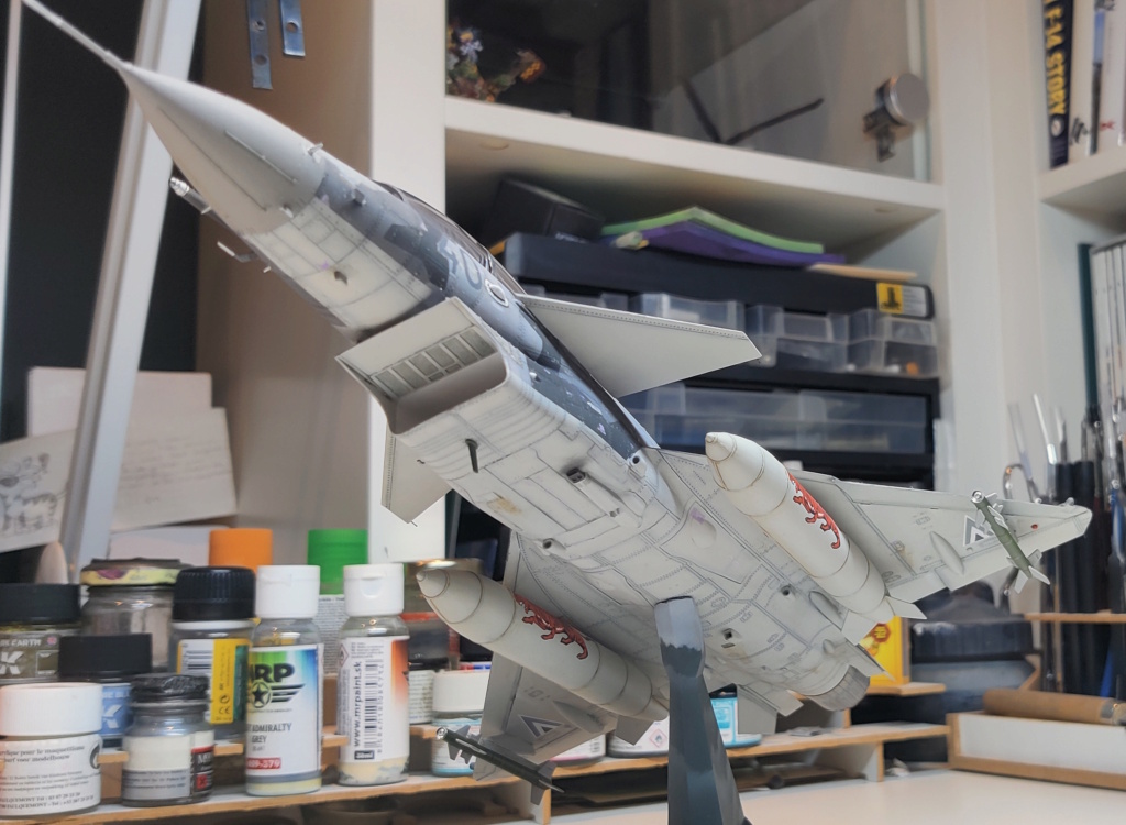

Overall a fun build and a challenging but fun paintjob...
Cockpit

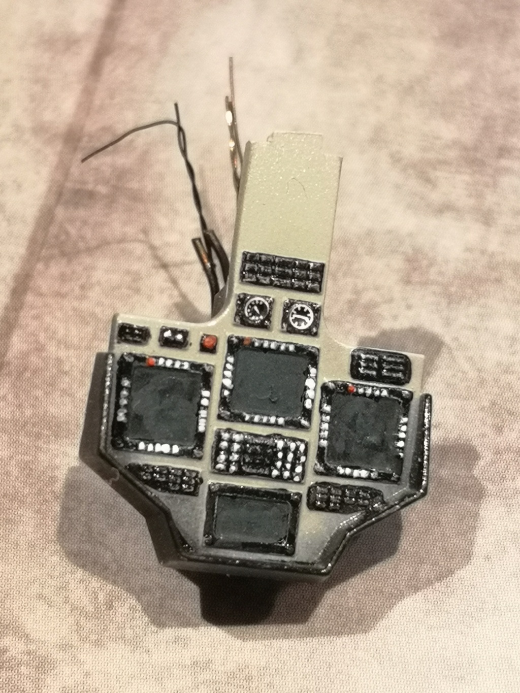

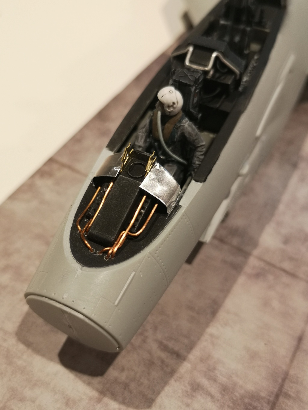

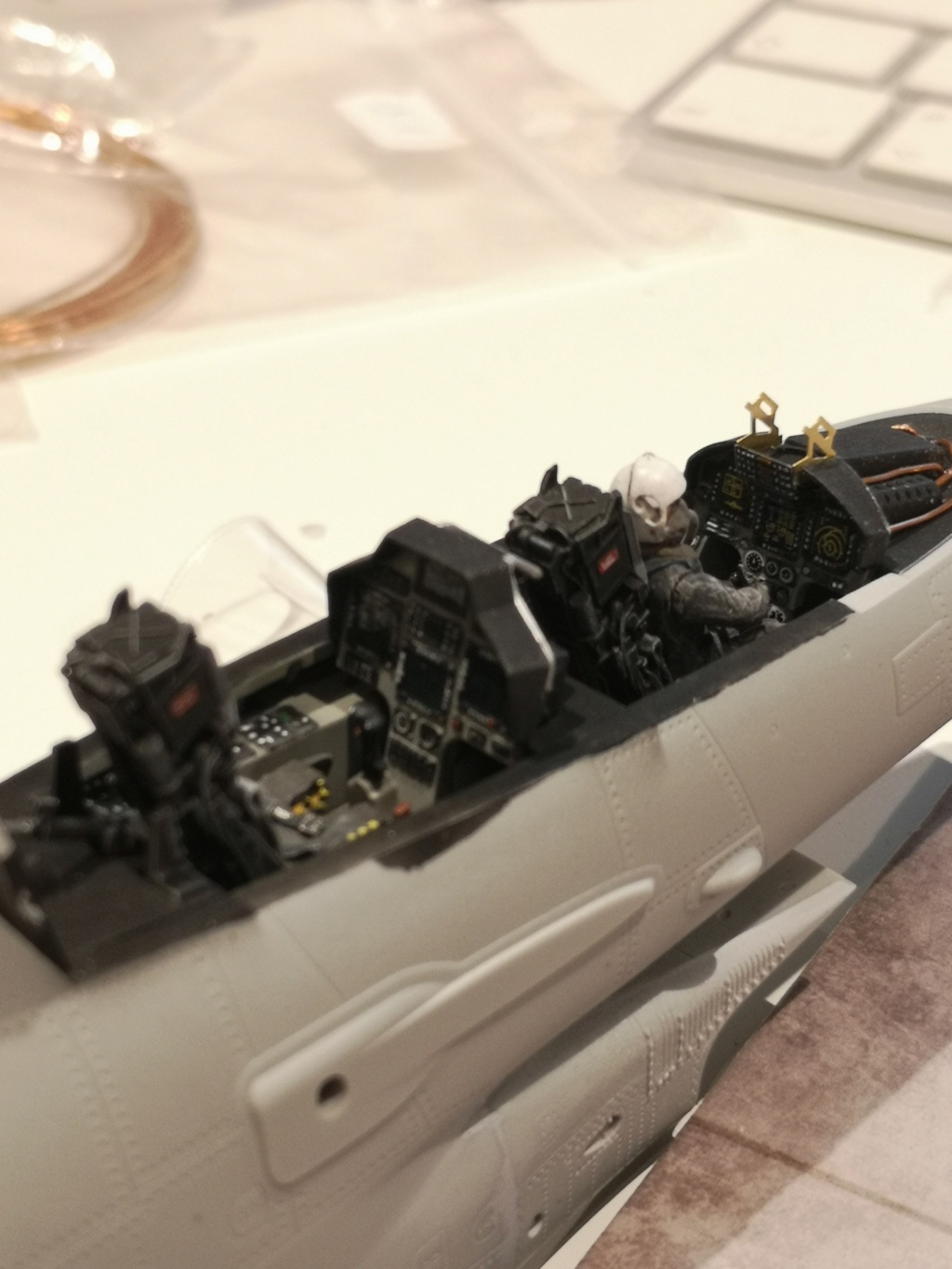

Pilot figurine had to be torn into new angles to fit the seat... which got replaced by aires ones (much better detail). Some détailing happened on the back sides of the panels. Dails and screens are decals (punch died).

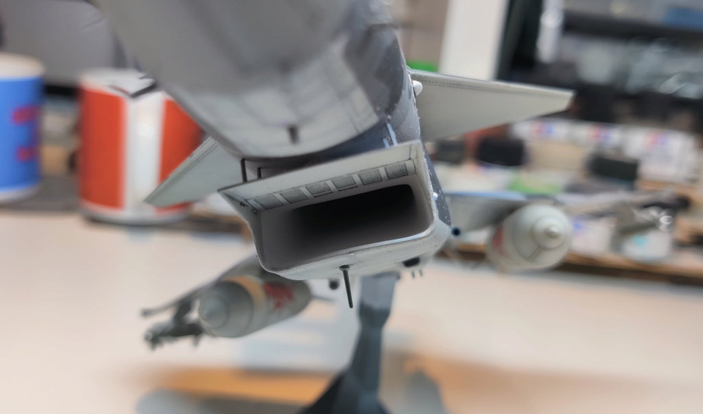

the airduct
worst and of the build was the airduct. Took a lot of sanding to get it seamless... and lets not talk about attaching it to the fuselage (tamiya putty to the rescue). In the end, it was worth it and using a F.O.D. would have saved me some time but would have looked plain weird
Exhaust

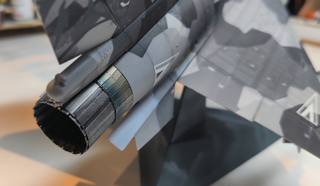

absolutely no doubt that the photoetch adds a lot of detail. Wasn't easy to install as the part of the Bronco are much different from the trumpetter one.

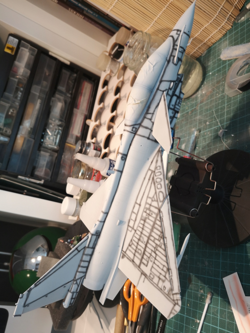

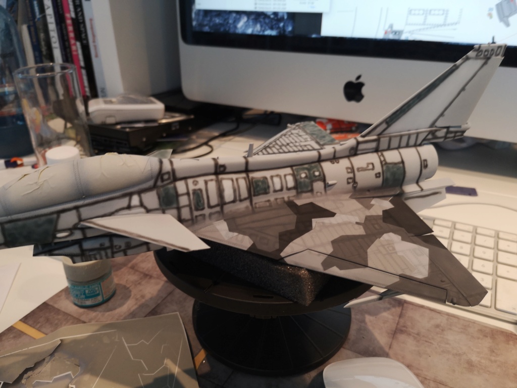

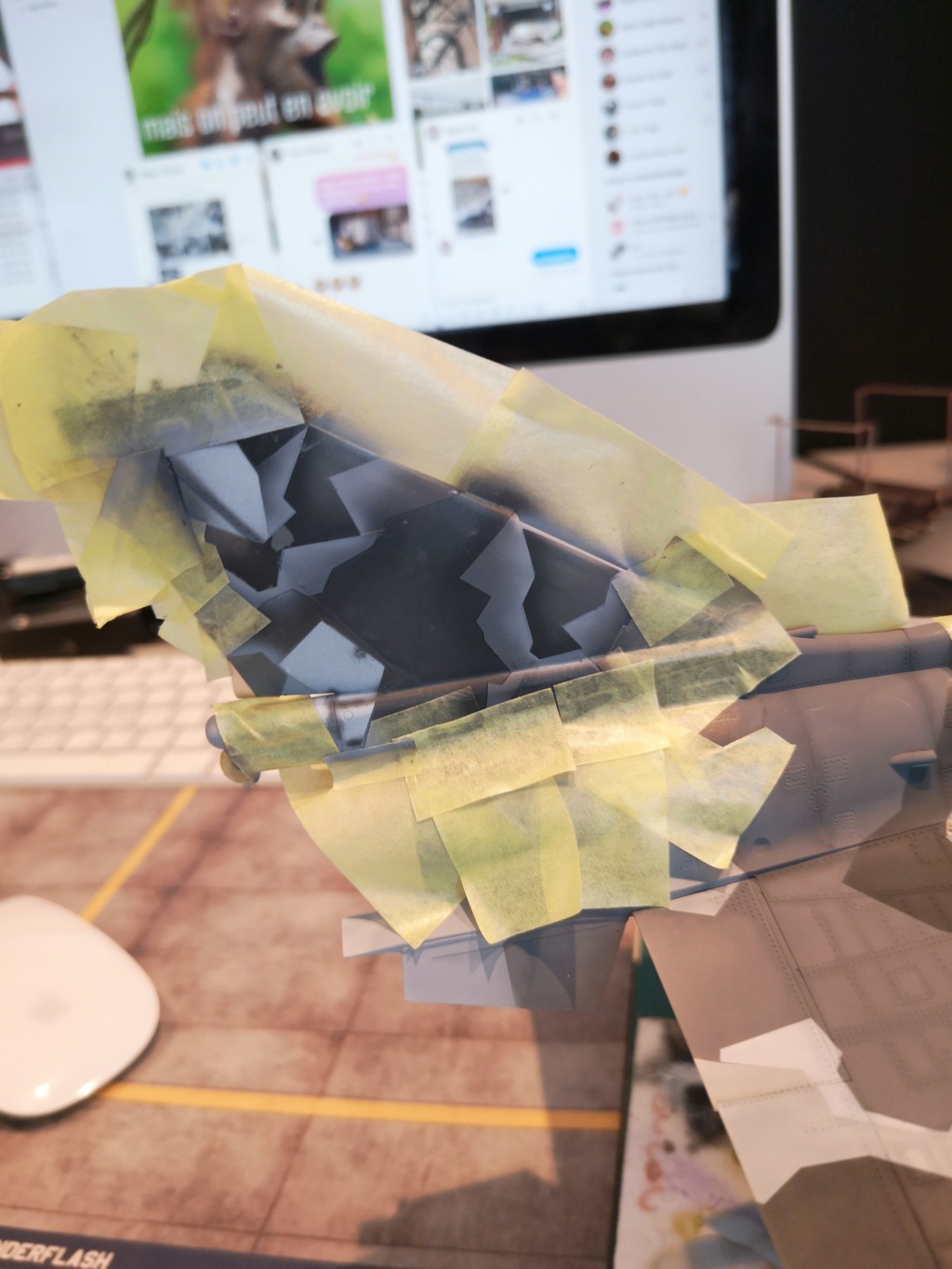

Paintjob

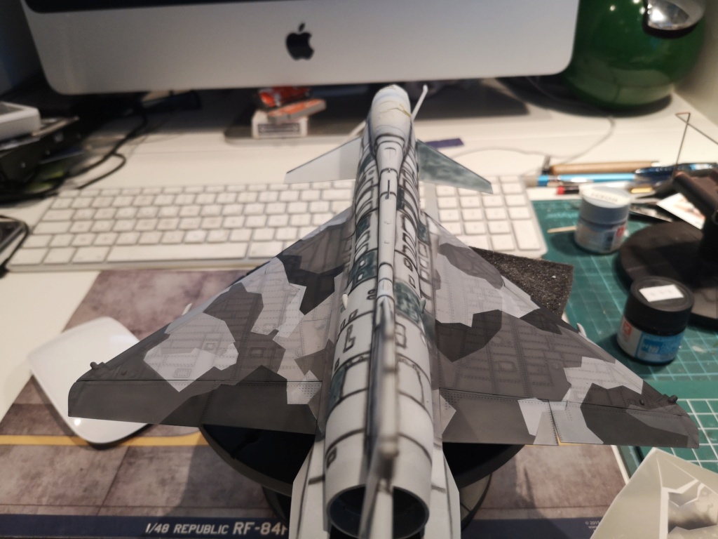

using the masks proved easy on the wings and vertical surfaces... tough part was the central part of the fuselage. Turns out the J10 is much slimmer than the Viggen, some cutting and adjusting was needed.
For the rest, a classic paintjob with preshading (lines and panels)... and lots of Tesa tape

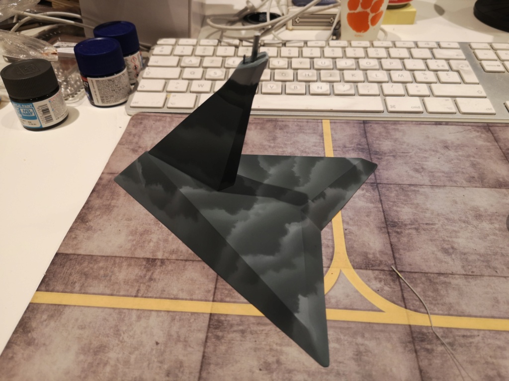

stand
stand was taken from a 1/24 Typhoon from Airfix (not from my stach, so not a future project  :banghead: ). Could effect is made using a piece of kitchen paper towel. Top was modified with miliput to give it the right angle to support the J-10

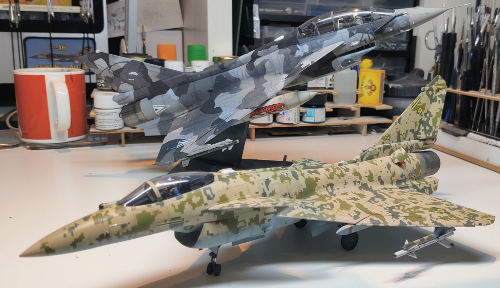

and as a final treat, a familly picture with it's evolved single seater brother J-10B... for those wondering, no precut masks were used, all hand cut during a summer exam session in College  :o ;D
hope you like it, keep on whiffing in 2022 :) comment are as always welcome :)
