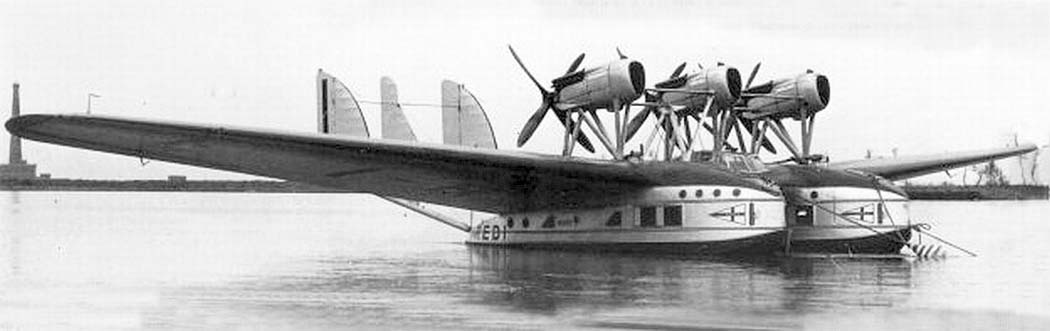

The two Fiat-engined Italian Dornier Do X had the engine nacelles mounted on pylons.
When the first Do X was originally engined with Jupiter radials, they were also mounted on pylons.
Oh yes, I do like the look of that setup.  :thumbsup:
Thanks for the pointer Jon.
Hm, a section of tailplane would work quite well for the pylon, maybe thickened a bit for crew access as Fred suggested?
It is, which is why it's called an S.77...............  ;)
#21
The radiators for the Fiat A.22 engines were in the leading edge of pylons behind
movable covers. The air intakes (oil cooler and carb air?) were below the fwd
propellers.
The Merlin XX of the Lancaster is only slightly larger (3" longer, 1" wider, 5" taller) than
the Fiat A22-R used on the two Italian Do X, so the nacelle layout of those aircraft is a
good guide for designing your installation.

Both the Jupiter and Fiat pylons had access hatches on the sides, you can see one on the
photo of the Jupiter test installation, and two open doors on the second photo I posted
of R.I. Umberto Maddalena.
