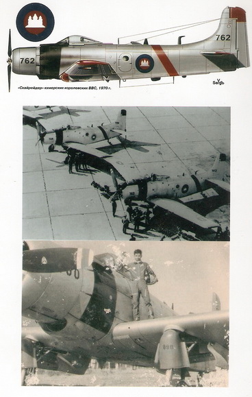

As already mentioned in the general discussion thread, I will be in with a simple build. I originally had the plan to build a real-world AVNK AD-4N some day, after I had found a profile and b/w pictures of these aircraft. However, when I recently dug through The Stash™ I came across a Monogram F8F (in a Revell re-boxing, though) and wondered about a different livery for this small fighter – and the AVNK idea popped up again. I also had a suitable roundel set at hand, and so...
