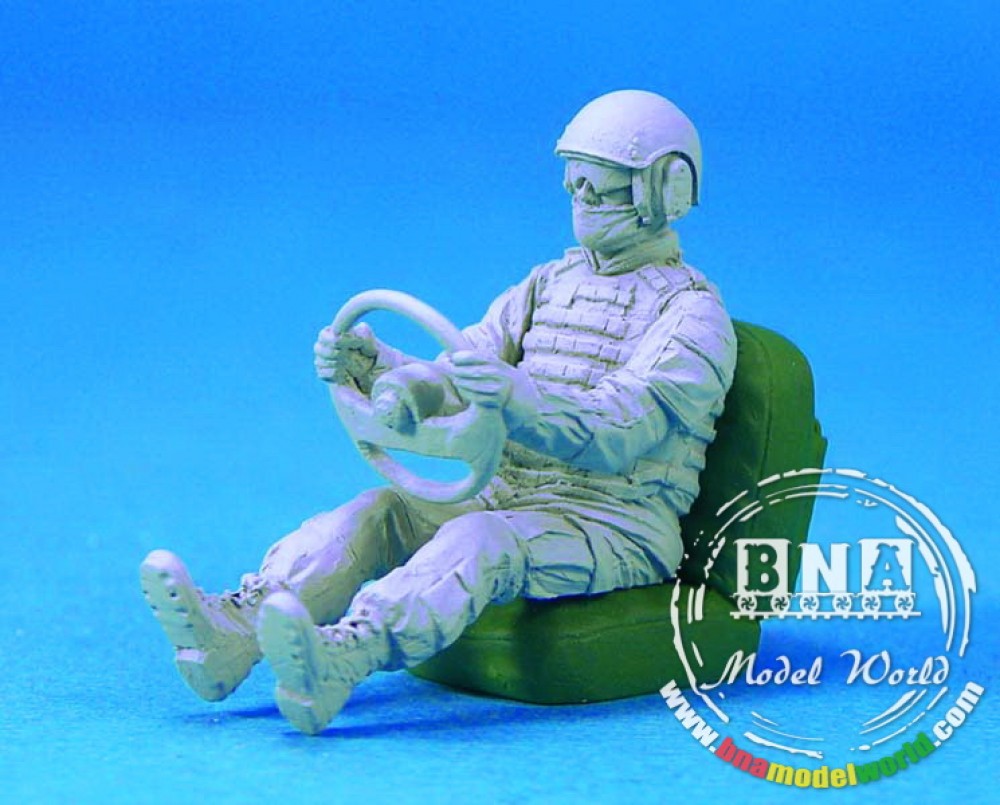

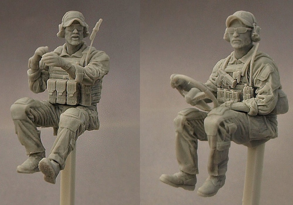

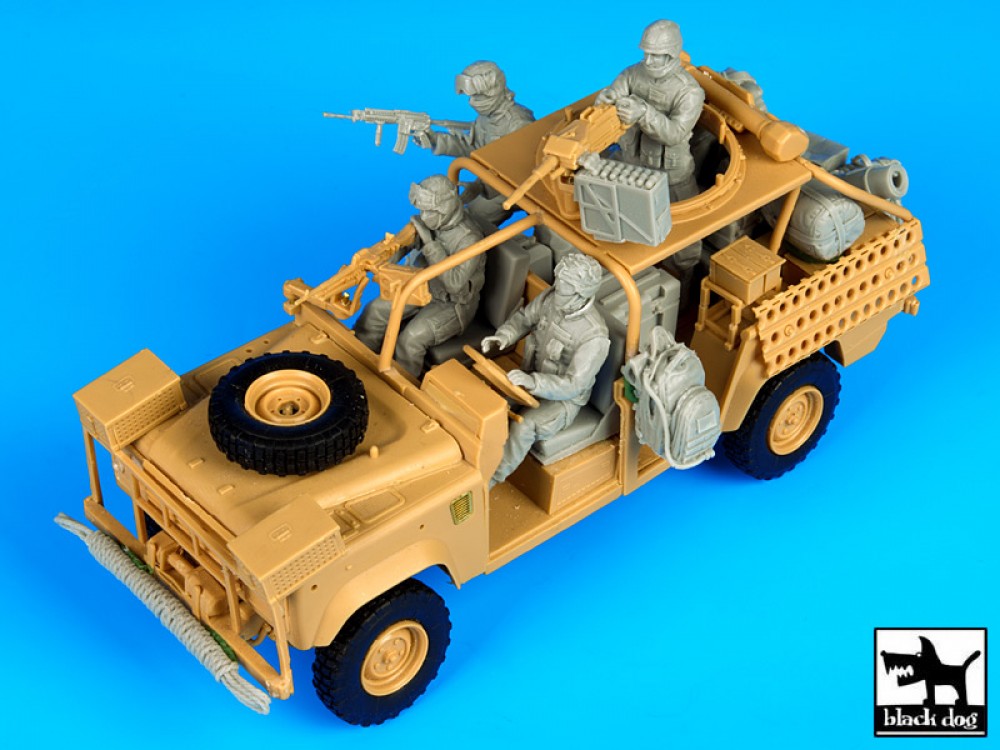

After a quick search:
1/35 US Special Forces Humvee Crew in Afghanistan (3 Resin Figures)
https://www.bnamodelworld.com/model-figures-ac-models-acm-35002-1:35-us-special-forces-humvee-crew-in-afghanistan-3-resin-figures

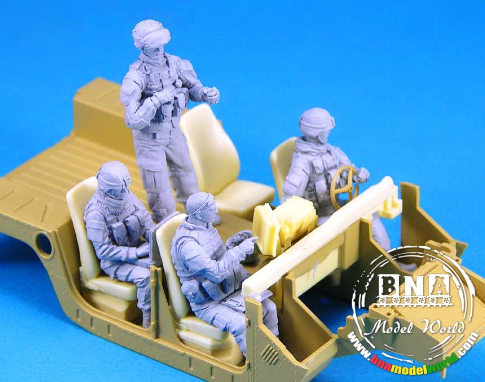

1/35 US Army Vehicle Crew Set (4 Figures)
https://www.bnamodelworld.com/model-figures-legend-productions-lf0129-1:35-us-army-vehicle-crew-set-4-figures

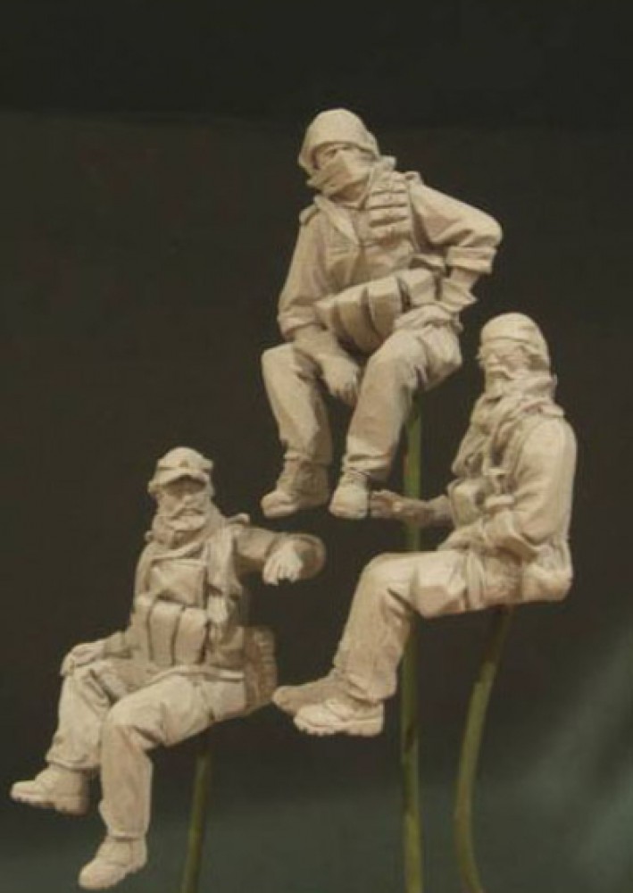

1/35 Special Forces Polaris Crew (2 figures)
https://www.bnamodelworld.com/model-figures-airborne-miniatures-abm3535-1:35-special-forces-polaris-crew-2-figures
1/35 US RSOV Accessories & Crew (4 Figures) for HobbyBoss kit
https://www.bnamodelworld.com/model-figures-black-dog-bd-t35079-1:35-us-rsov-accessories-crew-4-figures-for-hobbyboss-kit
1/35 US Army Stryker AFV Driver
https://www.bnamodelworld.com/model-figures-legend-productions-lf0133-1:35-us-army-stryker-afv-driver
