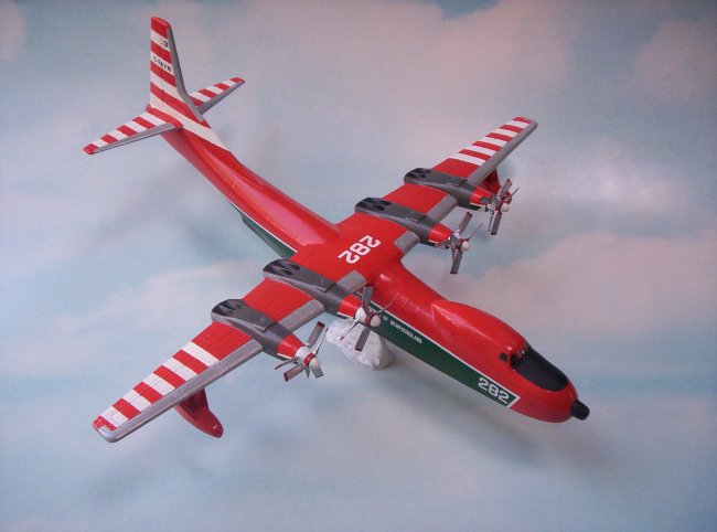

I've built 2 of the Revell ones. The big thing to tackle is RIVETS!, which, if scaled up, would be like tennis balls. The seam at the front, where the nose lifts, is very noticeable unless you just fill it and forget it. The wing floats are a bit fiddly to get into position, when sanding down the rivets don't erase the locating points. The horizontal stabiliser is a one piece, and if care isn't taken it can set on an angle. You can add a bit of detail by drilling out some of the portholes on the sides and filling them with white glue. No flight deck transparencies provided, so you'll also need to fill them with white glue.
Those two builds are gorgeous Dave !!!!!!!
The Newfie one looks so right Ratty ! I can just imagine seeing that
