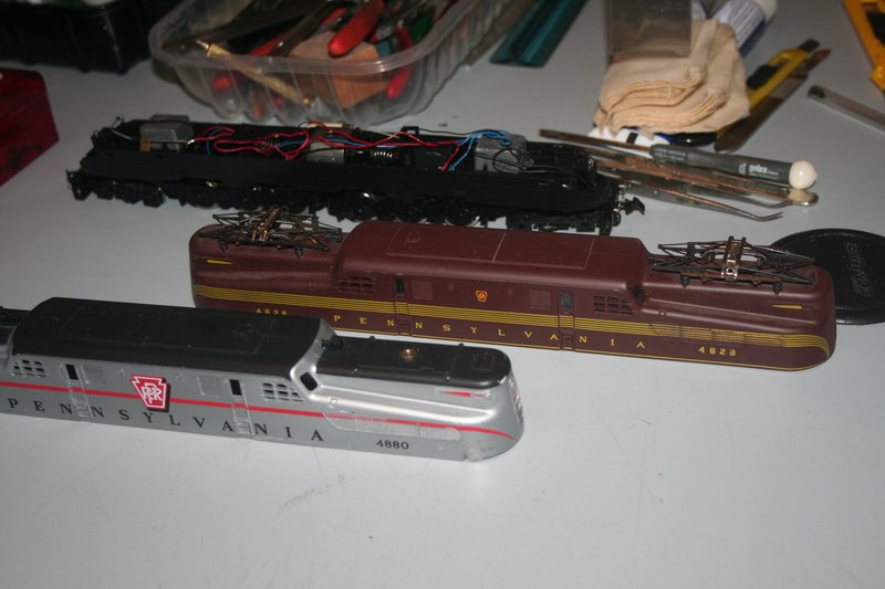

We have already discussed about GG-1 painted for railroads that never had it.
Now I find myself with 2 Mehano GG-1, one missing wheels and front trucks, the other with a cracked body and damaged frame (both very cheap, of course).
Yeeech! The gearboxes I had to open to get wheels and gears were completely filled with old grease  :banghead: , needed to clean everything in alcohol.
So I have put together a complete working frame from the 2 incomplete/damaged. AND have 2 bodies (the crack on one has been re-glued).
If I can manage to prepare templates for painting the Warbonnet, and find decals for the thin separation stripes (with a relatively close shape), I'd love to do a Santa Fe one.
AND, as a pet railroad for me is the Ferrovie Nord Milano, known for having a light track and railbed, what would be more appropriate than a GG-1?  ;D
Problem now is removing the paint: a 20 hours bath in a drain cleaner  has done absolutely nothing, Must find something else.

After a week in a drain unplugger did nothing, I sanded away the markings with a VERY fine abrasive paper, and started the paint job.
Bad masking and proportions, I wasn't satisfied, so put the body in alcohol. I use Vallejo acrilics, so alcohol is good enogh for paint removing.
And, SURPRISE, it removed also the original paint. So, back to pants with a nice and clean body.
Redid the shape of the separation line with Inkscape, and used it to trace a mask on adhesive foil. Painted chrome, masked, did the red...
I am AGAIN not happy with the result: owing to the GG-1 loong noses, the chrome section is too short, and, checking photos, verified that the separation does NOT run through doors etc (apart from giving masking issues).
So, back to an alcohol bath, and to Inkscape to modify the decal shape.....
