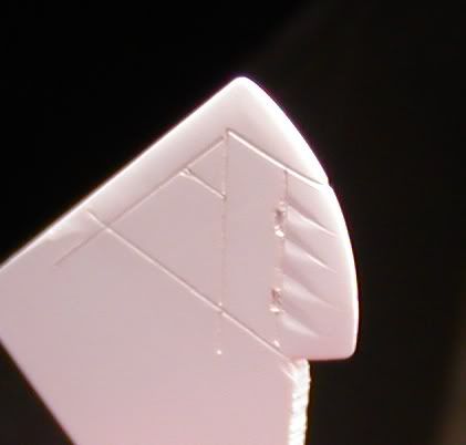

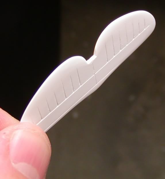

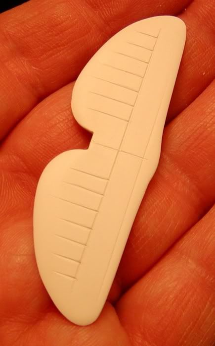

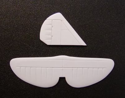

Here's the stabilizer, hand-shaped from some 40 thou styrene sheet.  One of the very few times where I can honestly say the real thing looks better in person than it does in the photos here!

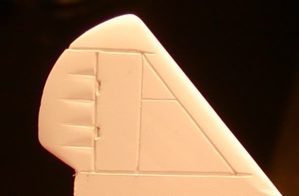

And the homemade tailfin, also shaped from 40 thou sheet:
