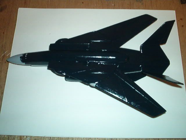

Wicked beastie.
So, just what would its performance capabilities be for its most common mission profiles?
Just how much more G's etc. could some a/c like this pull without having to be restricted by the limitations of a human pilot?
:o
Without a pilot, you can increase the G-limit until you run into structural limitations. Current missiles like the Aster can maneuver at 45 G. For an aircraft of this size, the limit will be lower, or you'd end up with an aircraft with no range and no payload. 12 G, maybe 15 would be realistic, I think. You may need to redesign the engines, ISTR some jet engines would flex enough under G-loads that the blades would run into their shrouds.
QuoteWithout a pilot, you can increase the G-limit until you run into structural limitations. Current missiles like the Aster can maneuver at 45 G. For an aircraft of this size, the limit will be lower, or you'd end up with an aircraft with no range and no payload. 12 G, maybe 15 would be realistic, I think. You may need to redesign the engines, ISTR some jet engines would flex enough under G-loads that the blades would run into their shrouds.
Yeah! Just what Hobbes said.  :D  ;) I was going to say about 13 G's but I'm not too sure with the wings extended. Just enough to be able to preform the Wild Weasel and ACM mission, to be sure. :)

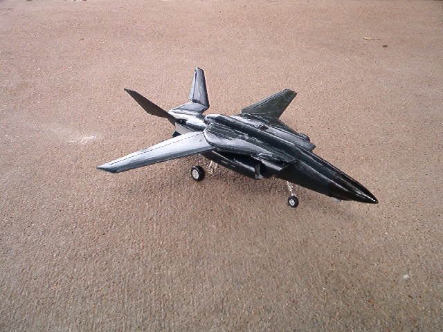

I can't see the brush marks in the pics but I know they will drive you nuts if you see them. Make sure you get your paint nice and thin, if it's to thick it will speckle coming out of your airbrush.  Much better to paint a few thin coats especially with a gloss paint.
60% paint  &  40% thinner works pretty well but experiment before shooting your UAV.
Also start and stop your spray before and after your target... sometimes your airbrush will spit when you first press the trigger. Also watch out for build up on the nozzle. and clean brush as soon as possible.
Airbrushing is 80% prep and clean-up and 20% painting...seems like a lot of hassle but when you get the hang of it the final results are well worth it.
Your UAV is simply wicked!!!
Looks positively evil, mysterious and menacing and everything else it should look to play the part.    :ph34r:
If you wet sand it with microgrit sanding sponges (like the ones up to 30000 grit that you can get from MicroMark.com ) you probably would not have to repaint, actually, depending on the level of gloss/matte you seek in the final product.
But, then again, it IS time for you to pull the Aztec out of the box and let her rip.
It's a very forgiving airbrush.
DON'T FORGET THE MASKING!!!!  (At least there's no canopy, eh?).

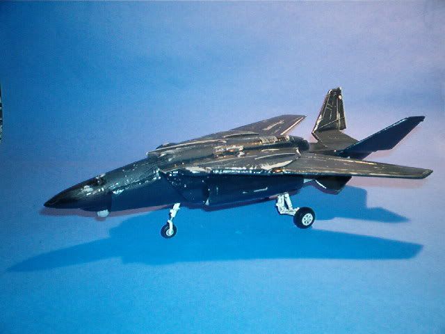

I don't know I kinda like the "been through hell and back" look it is currently wearing  :P
Looks badass nomatter how you finish it!

It looks just sooooooooooo eeeeeeeeeeeeeviiiiiil............
:wub:  :wub:
Now that is a Bird of Prey
Chris
Menacing and sinister..I LOVE it... :wub:  :wub:  :wub:
Yep, I'd be tempted to leave it "as is."
There's no reason why UAV's wouldn't get all weathered in a genuine conflict, right?
