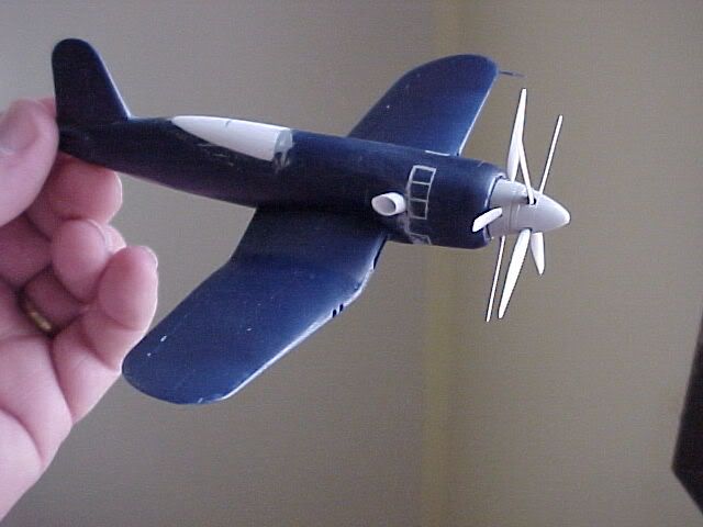

I started fiddling around with the few kits I have to hand here, plus a load of glue, filler and sheet and tube plastic.
I don't have suitable floats as yet, but I am home on holidays in two weeks so I will see a good donor kit while there.

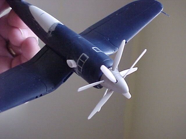

The entire cockpit area was razor sawn off and laminated plastic glued in to fair in the fuselage area. Still some filling and sanding but it has ended up with quite a nice transition.
The propellor is the contra-rotating one from the Trumpeter Wyvern, and the wing tanks and torpedo will come from that kit as well. I have pretty much worked out how to adapt the Wyvern prop to the Corsair shaft so that the assembly can still rotate fully.
I may make the tanks tip mounted, or mount them underwing outboard of the floats, which will mount to the lowest point of the gull. The fold lines and gun ports will be filled, but the wing root oil coolers will stay as even Turbo-props need them.
The premise of the British prop and engine, torpedo and tanks is that this is a Fleet Air Arm project, so it may even get done in dark grey and sky with Suez stripes.... ;) Inspired by Jennings drawing of the late mark Corsair in FAA colours...

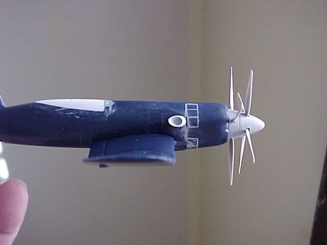

The cooling flaps are to be fully filled and the cowling lines rescribed to reflect a four part "petal" arrangement. The exhausts of which I have only done the left one so far are scratchbuilt from plastic tubing thinned and capped at the end.
I am also thinking of adding the -5N radar pod as part of the unmanned ship targetting setup.

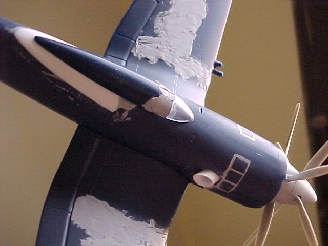

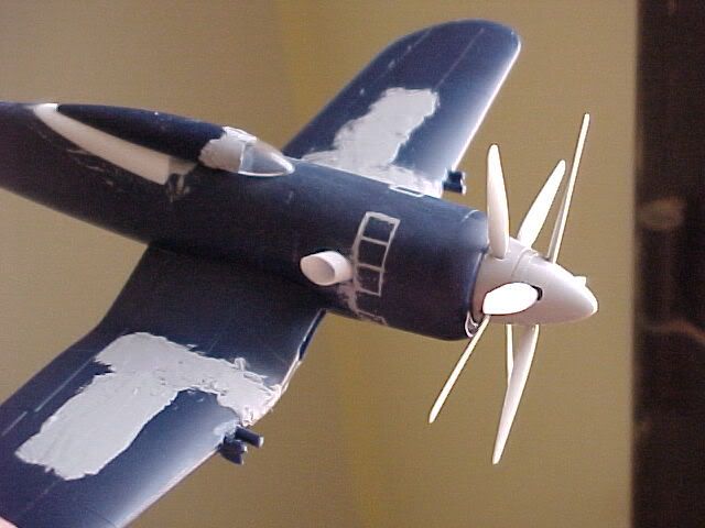

For Captain Canada and Aeroplanedriver I decided to see what it would look like as a manned version.
After all, a lot of early drones had some sort of cockpit setup if only for test flights.

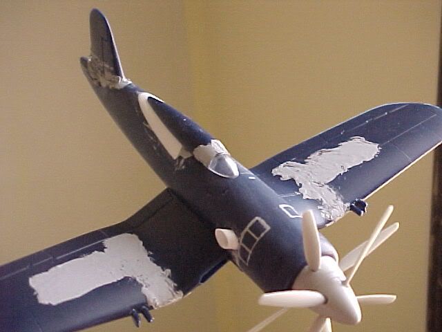

The low profile racing canopy is half of the droptank in the kit with the front sawn off and replaced by the cut down canopy from a 1/100 scale Tamiya Me-163. The filler will fair it in when dry, rubbed down and polished.
The filler around the tailfin is where I cut it off and reset it to zero offset. Of course, the original Corsair had a huge radial engine swinging a huge four blade prop, thus a lot of torque. A contra-rotating prop should have much less, so the fin offset had to go. Cut, glue, fill!
The rest of the filler is to fill in the wing folds, gun access panels and wheel wells. The guns are glued in merely to fill the holes, they will be trimmed and sanded when dry. The rear wheel well and hook recess is also being filled and smoothed and I will probably add a ventral fin.
