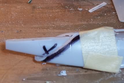

Now to the fuselage. Slice into three pieces
Then take the end piece and slide it into the hole in left in the fuselage and that should give some solid styren to sand and shape. The end result is probably gonna be alot shorter
