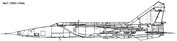

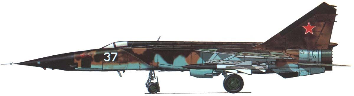

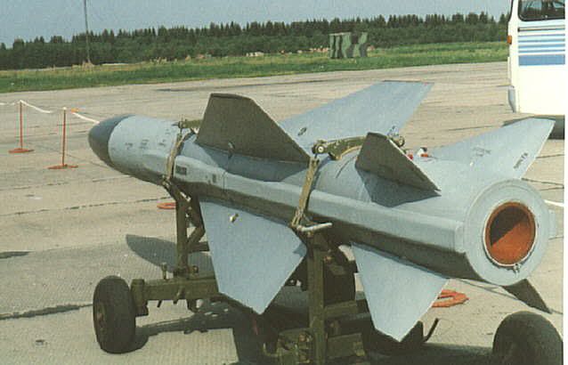

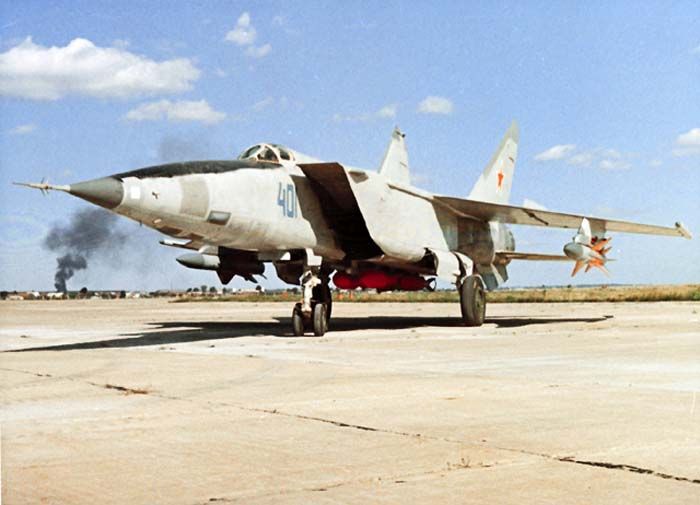

QuoteWhat kind of modifications would I have to make to a standard Foxbat to make a SEAD one? What kind of loadout should it have?
As overscan said, you would probably use the MiG-25BM as a reference point, since it was the Russian/Soviet SEAD MiG-25 variant.  As seen in the pics below, the nose was remodeled to remove the original radar and replace it with systems for the SEAD role (the Jaguar antiradar system, target designation system for the Sych antiradiation homing missile, defensive electronic ECM system consisting of the Beryoza-L radio surveillance system and Syren-1D-OZh and Lyutik active jamming systems to be exact).  As for weapons, the KH-58 ARM was the primary weapon, though gravity bombs could also be carried (as shown in one of the pics).  I have included a couple of pics of the KH-58 for you as well.

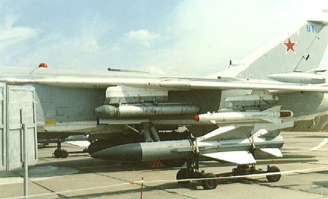

GTX:
What is mounted on the inboard underwing pylon in the fourth picture down?  It looks like a silver panzerfaust, but obviously that's not it.  Modern aircraft are not my strong point!
Thanks,
Andrew

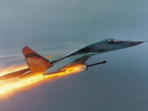

#23
QuoteWhat is mounted on the inboard underwing pylon in the fourth picture down? It looks like a silver panzerfaust, but obviously that's not it
Andrew,
Believe it or not, but you're not that far off - I believe it's actually an S-25-OF heavy unguided rocket still in it's launch tube.  Here's a picture of one being launched:
