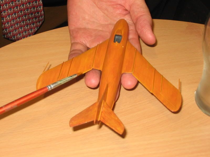

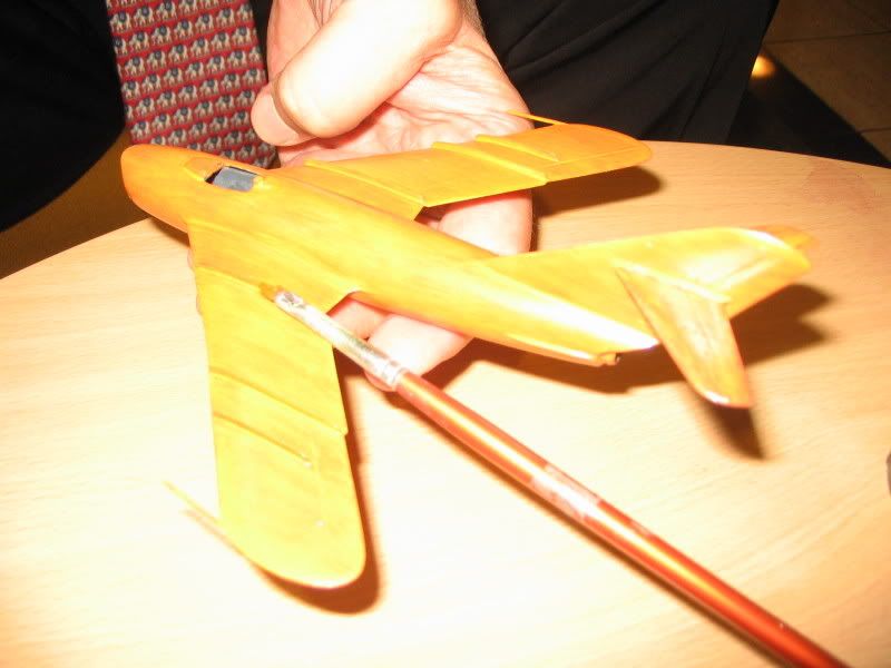

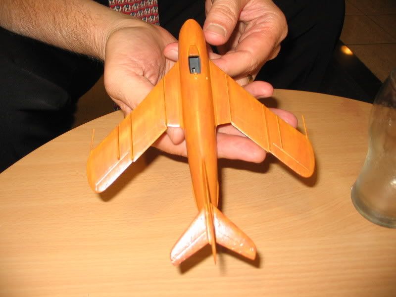

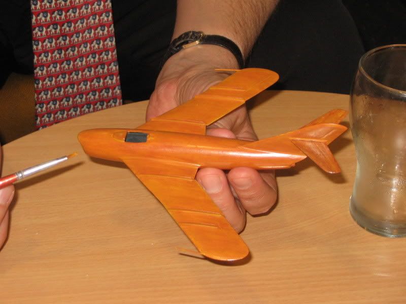

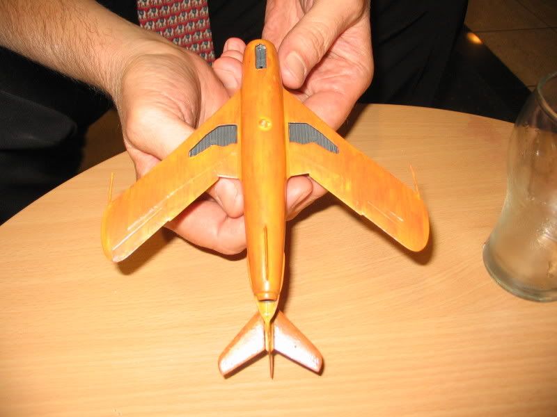

Here she is, the little-known 1968 wooden MIG 17 as flown by the NV Air Force.
Undercarriage and decals not on yet. I just might need some weight in the cockpit, but that won't be a drama as I have a lot of shotgun pellets that I can attach with white glue and then paint some dark color.
In the shots, you can see my home-made rake brush, which I made by hacking at an old brush with my modelling knife and a pair of toenail clippers.
There is a blemish under the fuselage, but I'll hide that with a round black decal or two to represent a camera apertures.
You might be wondering how I did the wood finish.
First Humbrol 103, a matt sail-like color all over the plane to hide the silver plastic.
Then Humbrol red, yellow, tan and white mixed together to produce a sort of yellow ochre.
Then a very thin coat of yellow, followed by a thin coat of tan and another thin coat of burnt sienna acrylic, all brushed on unevenly with my rake brush.
Then a coat of rubbing alcohol. It may have been my imagination, but it helped sort of mix the colors together.
Lastly, I applied about 5 coats of yellow mixed with the OZ version of Future to produce the varnished effect. Tailplanes were done the same way, but a little darker.
And here're the shots
Well, whaddya think?
Next, I'll put a wash and some silver in the wheel wells and add the undercarriage and decals.
Wheelwell doors wiill be wood too, as will the canopy framework.
Allan in Canberra
