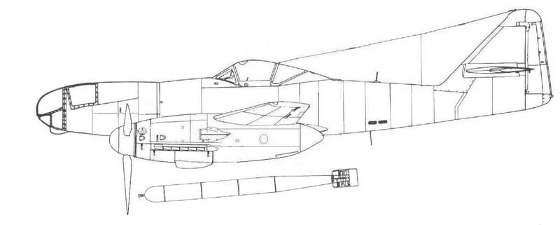

And lets not forget the high speed torpedo bomber:
Maverick
That torpedo ship is too cool Greg,
Methinks you're gonna have to start colouring these.
Mav

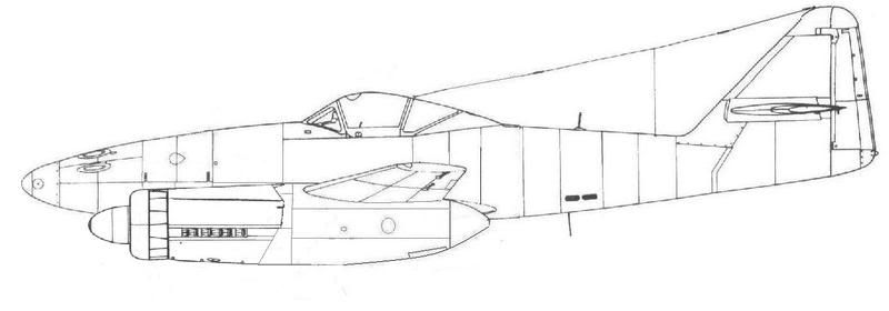

Quote from: GTX on April 14, 2008, 01:14:46 AM
Of course DB605s weren't the only engines trialed:
I would stick with the tricycle u/c and have the mains in the engine nacelles for prop to ground clearance.

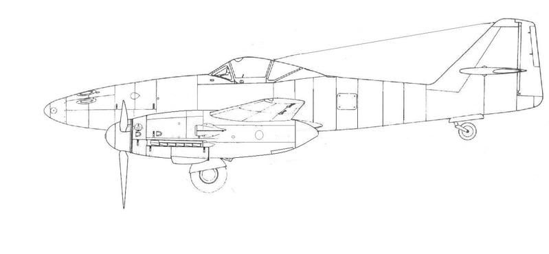

Quote from: GTX on April 12, 2008, 03:46:50 PM
Going the other way - what if the jets never quite made it - could the Me-262 have been put into service with piston engines?
It's crude I know.
Most likely it would not have had the swept wing.
Trike gear is a maybe.
Where are the radiators?
Jon
QuoteI would stick with the tricycle u/c and have the mains in the engine nacelles for prop to ground clearance.
Already planned - I figure the first tail dragger version was a prototype.
QuoteMost likely it would not have had the swept wing.
I've left the swept wing - If I recall, it was there just as much for weight & balance as anything else.
Long, stalky tricycle gear was planned.
Radiators are between the engines.

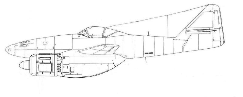

Yet another engine trial:
Quote from: Maverick on April 14, 2008, 02:27:08 PM
Mav
One thing at a time ;D
Quote from: GTX on April 15, 2008, 01:58:59 AM
The 18.5 degree sweep was introduced on the outer panels of an originally straight wing to shift the center of lift because the Jumo turbojet came in heavier than expected. The DBs are not mounted in the same position or fashion as the Jumo so the weight and balance would be completely different. The swept outer panels of the Me 210 turned out to be the source of some of its problems, thus the redesign on the 410.
Maybe 410 style wings/engine installation/landing gear on a 262 fuselage? It would work best for the forward cockpit heavy-fighter and schnellbomber designs.
Jon
