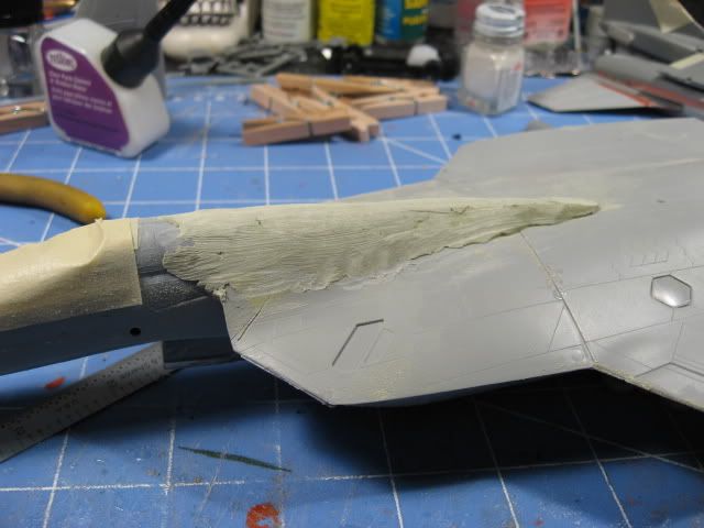

Milliput should be renamed Milliconcrete. I've never worked with before, so I slathered it on. Now I'm having to use my Dremel tool with a diamond tip attachment to sand it down! :lol:
I've always found Milliput quite workable, but I guess it depends on what you're used to.  Glad to see you've picked this up again Eddie!
Quote from: Mossie on March 20, 2010, 07:06:01 AM
I guess I expected something along the lines of filler putty. At least I should be able to get a very fine finish out of it.  ;D
It's probably a daft question, but have you given it long enough to cure properly?  It tends to 'snag' a bit if it's not yet fully dry, I generally leave it overnight.
The nice thing with Milliput is that before it dries, you can rub it down with your finger and some water, to get a nice smooth finish. Takes a bit of getting used to, but you can avoid most of the sanding that way.
Yep, it's concrete once fully cured.  Basically the same as much cheaper plumber's epoxy.
I let it cure for 2 days just to make sure it cured, and cure it did. Boy Howdy!!
QuoteThe nice thing with Milliput is that before it dries, you can rub it down with your finger and some water, to get a nice smooth finish. Takes a bit of getting used to, but you can avoid most of the sanding that way.
Thanks for the heads up. I will definitely use that idea the next time I use it. :thumbsup:
QuoteYep, it's concrete once fully cured.  Basically the same as much cheaper plumber's epoxy.
Plumber's epoxy will be on the next shopping list. Thank you! :cheers:
QuoteGood work and very interesting idea.
Thank you very much!!
Can anyone tell me if filler putty works over Milliput? I've gone too far to make a mistake now. ;D
Yeah, I've used Humbrol Model Filler over Milliput, never had any problems.
