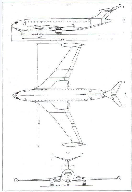

The sad part is the Short Belfast wasn't the best design, it was choosen on political grounds to ensure Shorts in Northern Ireland had work rather than the best design for the RAF. The Handley Page HP-111 was actually the outstanding design in the submissions and would have been more akin to the Starlifter than an oversized herc.
Shorts did propose a jet powered Belfast using the Starlifter wing & engines, however by then the withdrawal from East of Suez and a focus on NATO northern area removed the need for Strategic airlift during the 70's. The original idea being to withdraw the carriers and use fixed Island bases to police the East of Suez region at the expenses of a down sizing of the deployment in West Germany !.

Darn, the Short is already considered the "60's A400M" can't imagine this HP-111...
The Handley Page HP.111 was a transport using the Victor's wing & tail mated to a new fuselage.  It was offered to BOAC as an airliner & the RAF as a strategic transport.  The airliner variant would have been a B707 & DC-8 rival.
Lenny did a model of it recentley.
http://www.whatifmodelers.com/index.php/topic,19523.0/highlight,hp+111.html
