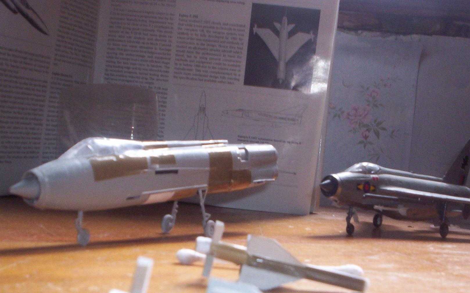

Frustrated in my atempts to make a Fairey Delta III, I chose to make another competitor to the F.155T : the P.8 from English Electric. It was a close derivative of the Lightning, but was also one of the first to be ruled out of the competition (with the Delta II close derivative and the P.1103). Of course, the Lightning took his revenge after the Sandystorm...
I recently bought a (crap) Lighning F3 from airfix, for seven euros (this explain why it is crap). My aim was to change it into a P.8, starting from Tony buttler book.
To do that, you have to change the canopy, undercarriage (on the flanc, not  under wing) and also scrap the ventral fuel tank (which is PART of the model, not a distinctive piece). I started yesterday...
First I cut the ventral tank. This was a good idea because the hole left was used to glue the undercarriage. Then, I scrapped the dorsal spine to put a canopy for the NOSA. Then I glued sheets of paper on the hole left by the ventral tank, leaving only a narrow hole for the undercarriage.
I add a small plastic part on the hole, cut the legs of the undercarriage(too long, the fuselage is lower than the wings) and glued them.
Now the future P.8 sits on its modified undercarriage, and also have a second seat.
here's the result...

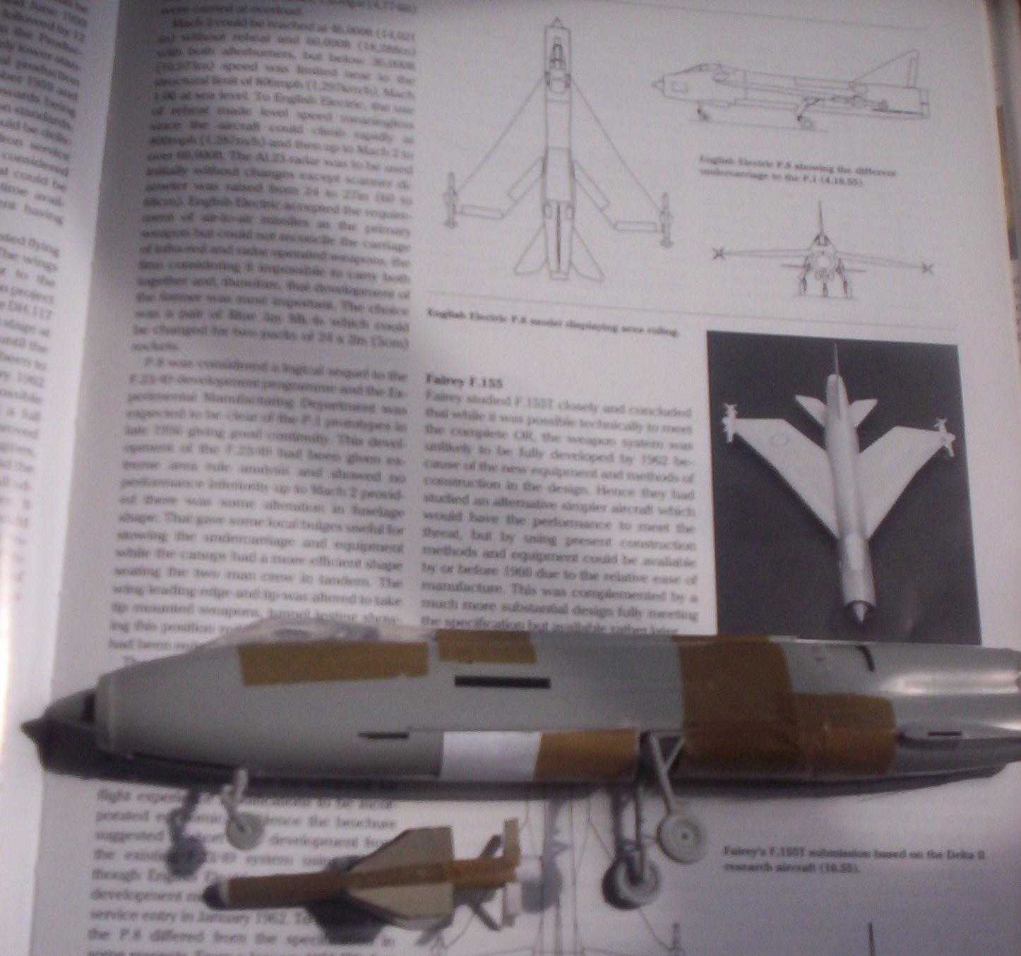

Archibald
Other photo (yes, Its tony buttler book behind, and a Lightning F6).

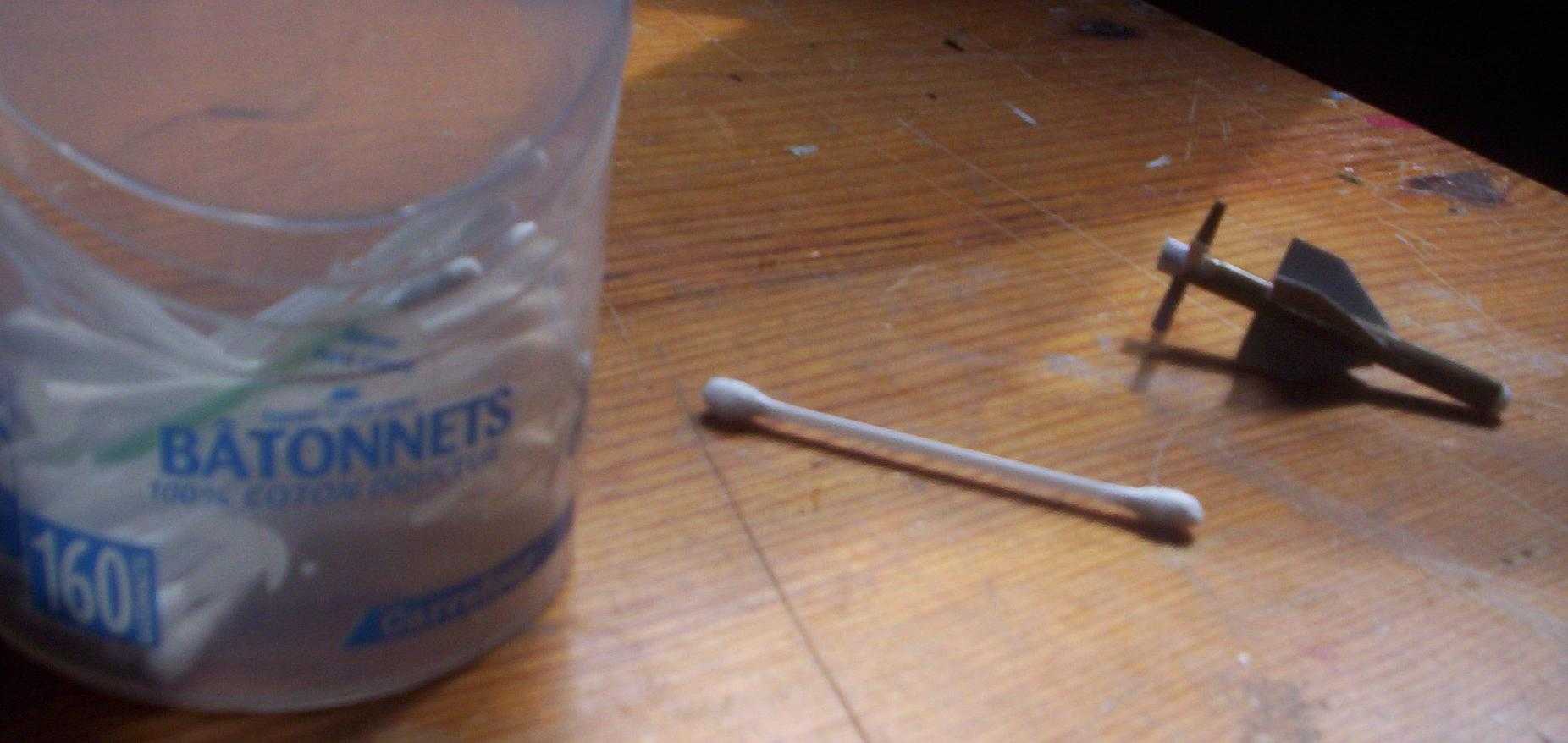

How making Red Dean (or Red Hebe) missiles from scratch.
I really wanted Red Dean or Red Hebe missiles on the P.8
I know the plane was not able to carry them (that's why it was rejected) but well I like this missile, and wanted the firestreaks for my P.1121. So...
From the left to the right : three stage of my scratchbuild Red Dean (:P )
retro_seventies
great stuff archie - very inventive with the old ear wax busters too!  :wub:
Archibald
Merci... thanks to you now I know how saying "coton tige" in english (ear wax buster) :P
