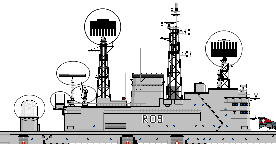

From a Shipbucket picture of Ark Royal CVA by Bombhead and Crazyhorse:
Would someone describe the names of the circled instruments and (if briefly) what they do?
Thanks in advance.

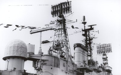

Looks like the real world installation on Ark Royal R09:
left to right:
1: Type 275 tracker (for 4") ?
2  Type 963 CCA  (AN/SPN 35)?
3: Type 974 navigation (Decca 12)
4: Type 983 height finder
5, 6: Type 965 AKE-2 long range air search (x2)
http://www.hazegray.org/navhist/rn/carriers/arkroyal/
dy031101
Oh so that cylindrical radome is that of the CCA radar (I thought the half-dome is)......
Ark Royal lost all its 4" cannons (all guns, for that matter, according to public domain info) by the time it started embarking Phantoms, so I never suspected that half-dome to be for gunfire control (or a radar capable as such).......
